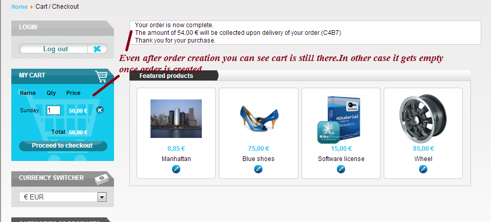

I am using Entry fields form.And after order creation cart does not get empty.I have got the same issue in demo site.Is this intentional or how can I change this?

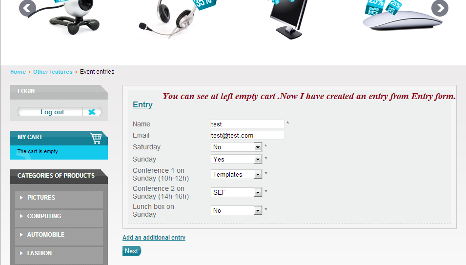

The problem is once order is created all cart products should be removed.I have attached two snapshot.
Please have a look and let me know if not clear.
Thanks,
