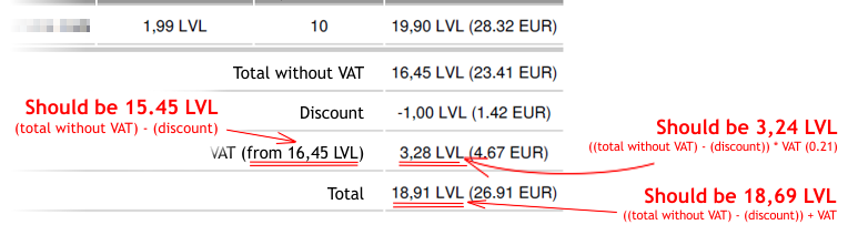

Hello! Our accountant pointed out that there is slight error in the way how hikashop applys bulk-order discounts. Problem, as it seems, is that option "Apply discounts After/Before taxes" doesn't work as it should. Please see attached order invoice as it's generated now:
You can see this in action by visiting link above, placing any of the products in cart, and then changing quantity to 10 - it will apply 5% discount, and You can instantly see this miscalculation in cart table.
Of course, I could just edit attachinvoice/invoice.php to correct invoices, but than price totals in Hikashop backend won't mach the ones in invoices sent to clients, so I'd like to undertstand what's wrong with current calculation logic...
Thanks for helping sort this out in advance.
Best regards, Arthur

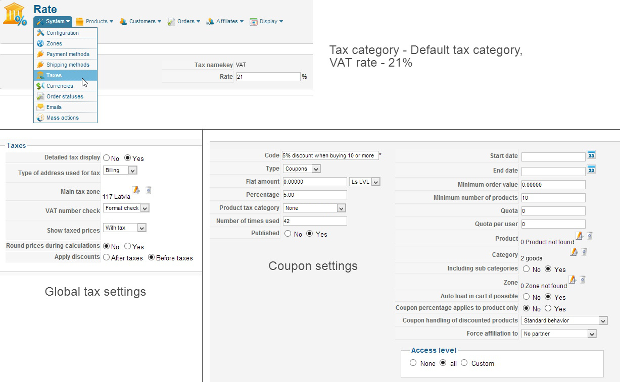

There are several ways to calculate the amount of a coupon based on the taxes or not.
First, you have the option "Apply discounts" of the configuration that you can change.
Then, in the options of the coupon itself, you have the "tax category" option that you can change.
You should try the different combinations of these two options. One of them should allow the system to calculate the taxes/coupon value like you want.

Nicolas, thanks for Your advice, but I have tried ALL possible setting combinations, and this still happens. Could You be so kind and check this out - I presume that I'm not the only one with this problem. Please see man current configuration below:
Up to this moment I simply rewrote attachinvoice.php, but it's not the solution, as You can understand - it's just a temporary fix becaus all the data stored in hikashop backend is still incorrect.
Last edit: 12 years 9 months ago by Savickis.

Just to be sure - what I need is that "TOTAL" for order would be as follows:
TOTAL = (Total without tax - Discount) + ((Total without tax - Discount)*tax)
so as in example in the first post -
18.69 = (16.45 - 1.00) + ((16.45 - 1.00) * 0.21)
Could You please tell me, where the Total calculation logic is stored to make it work like in my example above?
