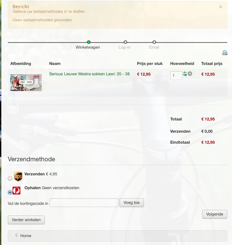

When configuring a shipment method for picking up products (override address) hikashop is unable to find a payment method. When a a (different) sent shipping method is selected a payment method can be found. How can I fix this?

12 years 10 months ago #131999
1. Following the payment method section of the FAQ will probably help you.
2. Can you show me how did you configured your payment method through some screenshots ?

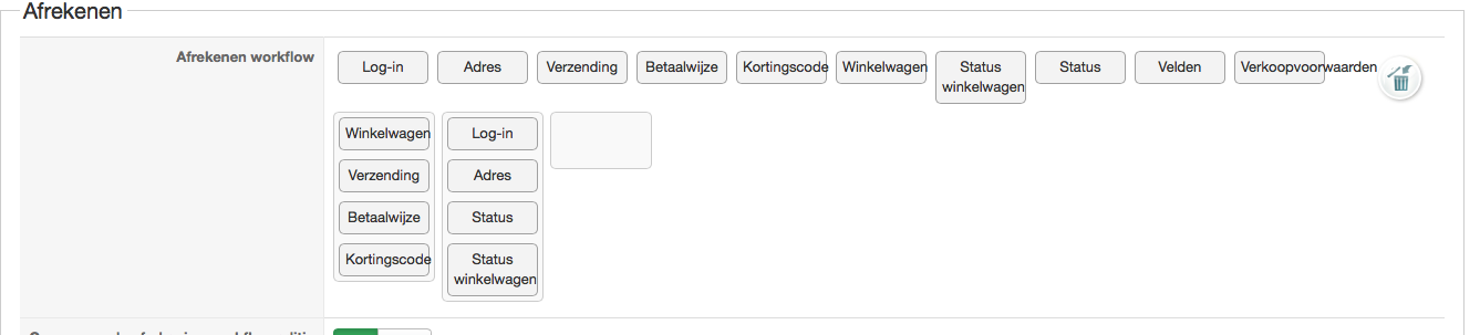

12 years 10 months ago #132000
You were unable te reproduce because I turned of the pick up shipping method. For now I enabled it again so you should be able to reproduce the issue. Also I attached my workflow and a screenshot of the incident.
12 years 10 months ago #132018
You'll probably find your answer through this thread :) :
Ok, your issue is probably coming from the way you configured your payment methods, so can :
- Go to "Hikashop->System->Payment Methods->'YourPaymentMethod'"
- Check if you have set a value for the Shipping method option, and unset it.
The following user(s) said Thank You: swaboe
