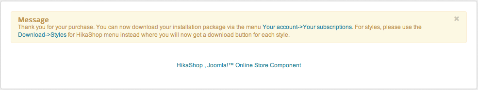

I need some guidance. I sell digital products using Hikashop. I just recently upgraded from Starter to Hikashop Essential. How do I add a custom message at the end of the purchase process, similar to the message I receive after I purchased Hikashop Essential (see the attached image)?
Basically, I want to place a message that tells the customer that they can access the downloads via a link on the menu, and if their order is not confirmed automatically to please use the contact form to request confirmation.

The best solution will probably be to add your message through the "End" file of your checkout view, of your front-end template through "Hikashop->Display->Views".

1. No, the changes are saved as overrides.
2. No. We simply changed text of the default thank you message with a translation override:
