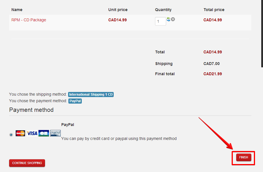

12 years 9 months ago #135752
I just tested it and it seems to be working fine, I just had to use the "Finish" button to be redirected to PayPal.

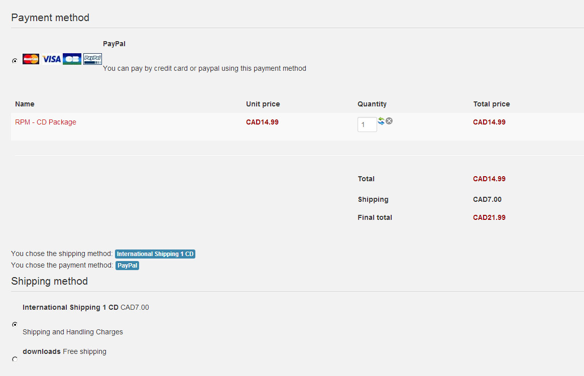

  • Posts: 18
12 years 9 months ago #135896
Ok, I'm attaching a screenshot. I have registered as a new user and then go back to the website to purchase a product. I put the product in the shopping cart, proceed to checkout where I log in. The information on the screenshot is now on the checkout page.
After I login it should detect my address (which is in north america). However it is showing international shipping. This is problem #1
The next problem is that there is no way to check out - no way to finalize the order and pay for the product. Nromally, there is either a continue button or confirm and it will take the user to paypal to pay for the product.
there may be another problem, I just changed the downloads under shipping so that when the weight is 0, the price will be nothing for shipping. However now under the checkout, it's giving the user the option to check downloads (no shipping) or shipping and handling.
Thank you, I would be so grateful if we can get this sorted :cheer:

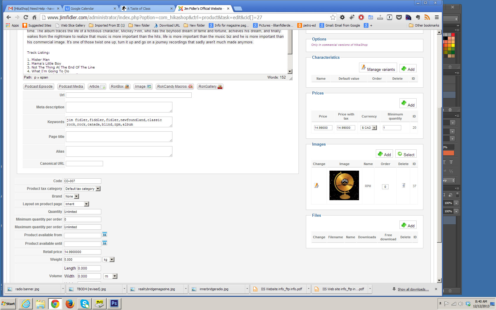

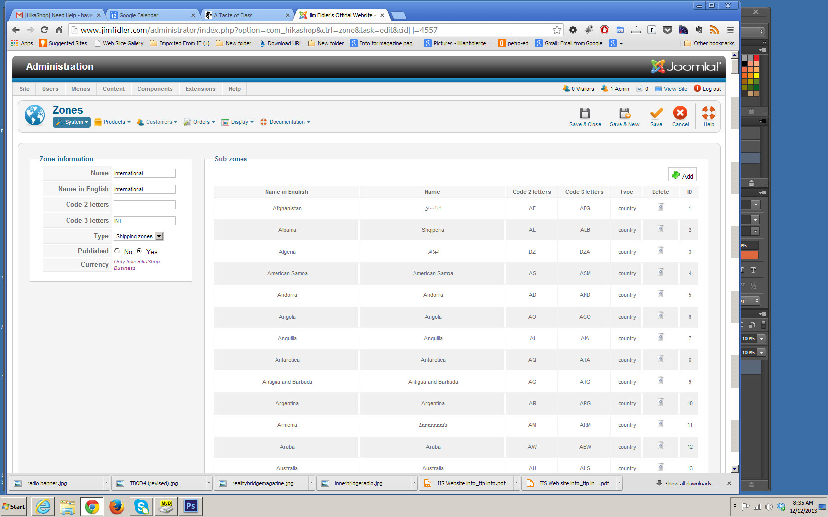

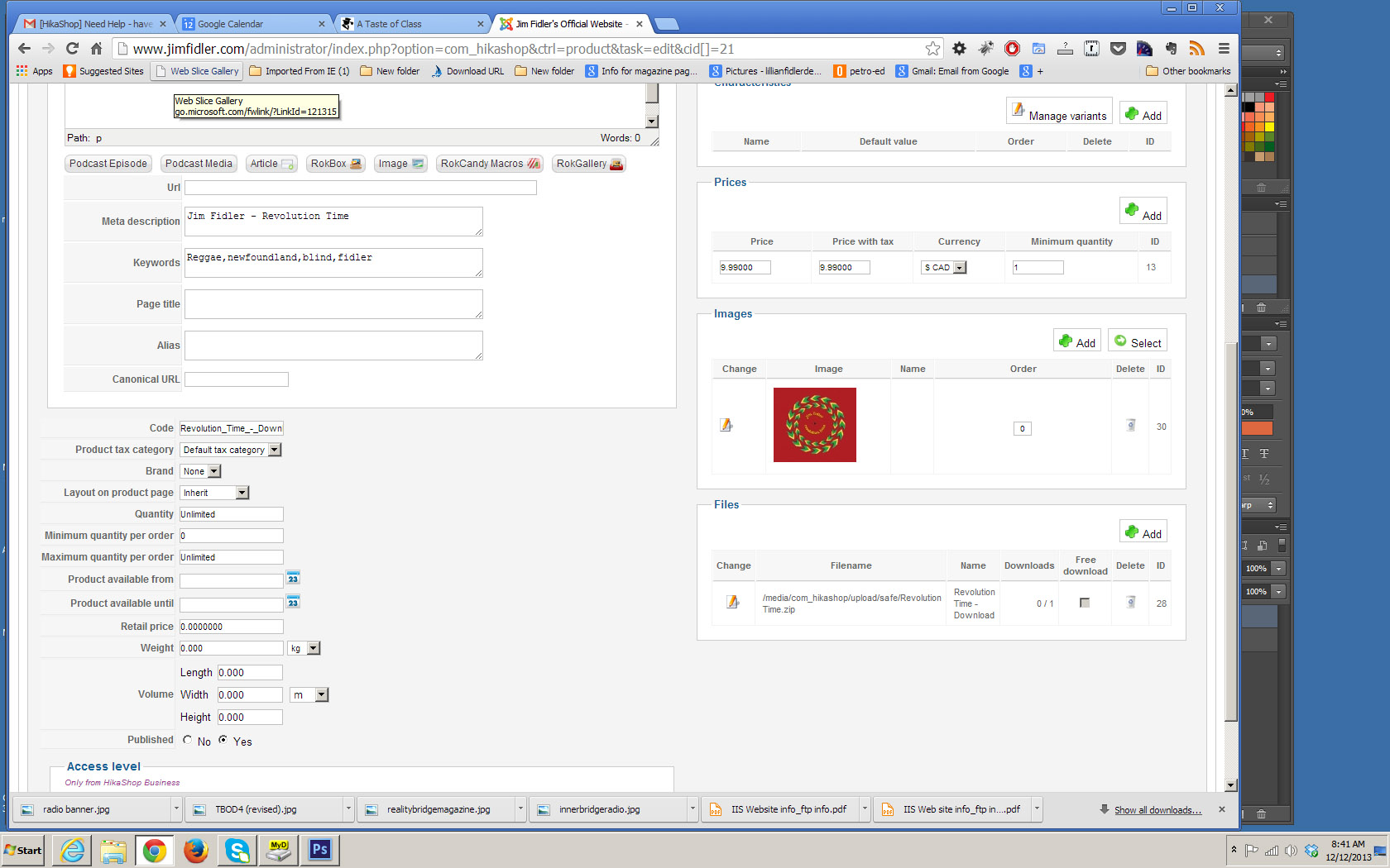

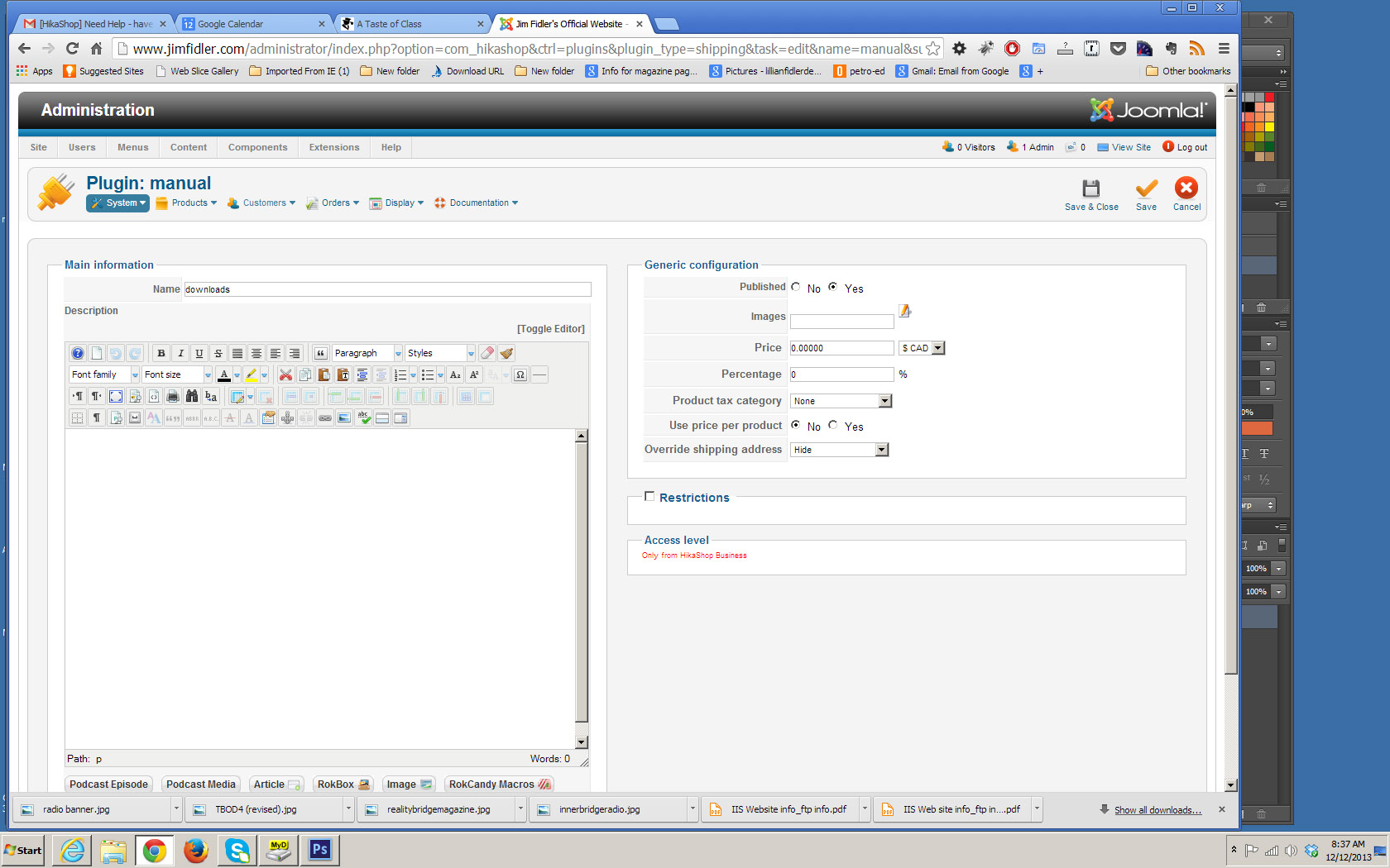

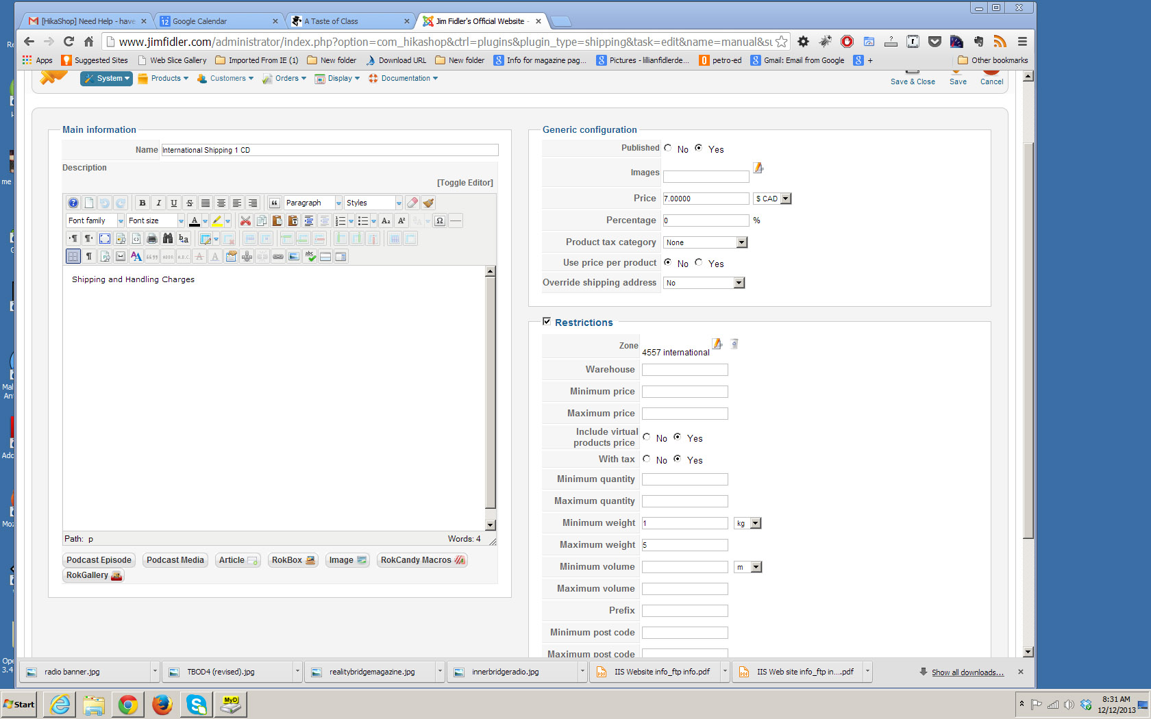

  • Posts: 18
12 years 9 months ago #136218
ok, I'm attaching the screenshots. When I registered I registered with my real address, which is in Canada. I hope this helps. This actually was working fine a few weeks ago as 2 people placed orders. I'm not sure what went wrong. It's just not working and you'll also notice that you can't checkout and pay.
If it makes it easier, I can supply the admin login details as well.
Many thanks!'
Lillian

12 years 9 months ago #136865
Regarding your first issue (the shipping issue), the best solution will probably be to give me a temporary access to your website so that I can directly test it, and understand from where the problem is coming.

12 years 8 months ago #137567
1. Regarding the shipping zone restriction, it's working fine.
2. For your "Download" shipping method which where always showing, setting the "Maximum weight" option to "0.1" mg will probably do the job.
