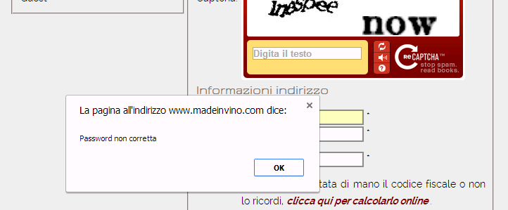

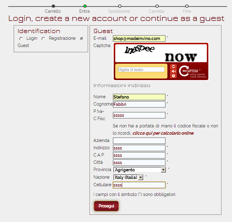

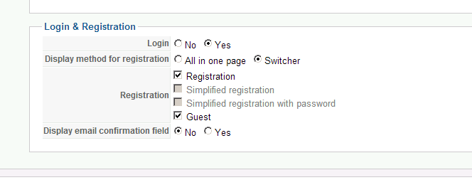

I would like to try to enable also the guest access to buy our products.
I did this settings:
When I try to access as a Guest I receive an error related to the password.
Is something related to my configurarion or is it a bug?

12 years 9 months ago #135877
I think that we already fixed that issue, so can you download the last Hikashop version through our website, install it and test it again ?

12 years 8 months ago #137404
Hello Mohamed
sorry for the delay, yes, it works with 2.2.3
Thanks for your help
