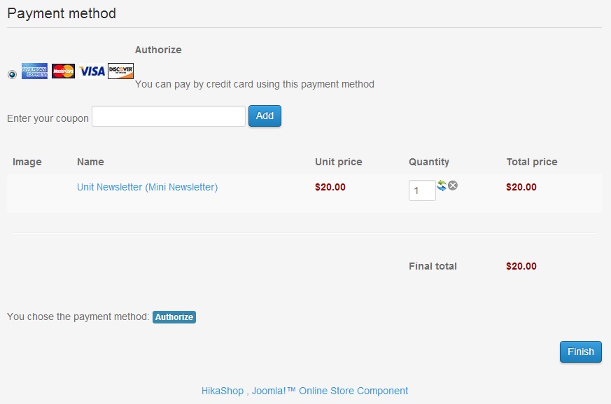

I'm using the Authorize.net plugin
It won't allow me even to the place to include my credit card number. Here's some screenshots
I successfully get to this point
Then I click the FINISH button and get this error message:
Hash mismatch
Reference ID: 202706570

It's probably that you have a javascript error on your website which prevents HikaShop from displaying the credit card form.
Please open your browser's javascript error console on that page and you should see the error message telling you what's going on.

12 years 6 months ago #147357
Yes....it's solved.
I was using the wrong info in my payment info section....
Customers needed to move out of my website into my payment system....so they didn't NEED to see a place to put the credit card number.
