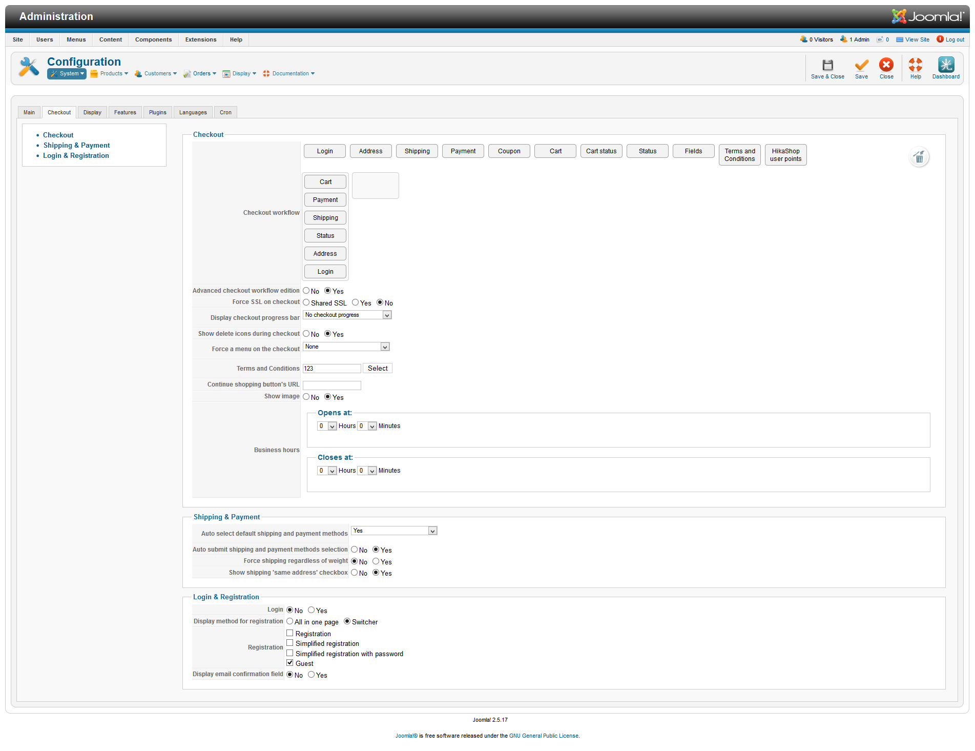

12 years 8 months ago #138367
Thanks to give us a screenshot of your checkout workflow configuration.
  • Posts: 80
  • Hikashop Essential
12 years 8 months ago #138379
2 screenshot attached.
it erase alle the filled boxes, in this picture, i have removed the check-accept_terms...
regards.

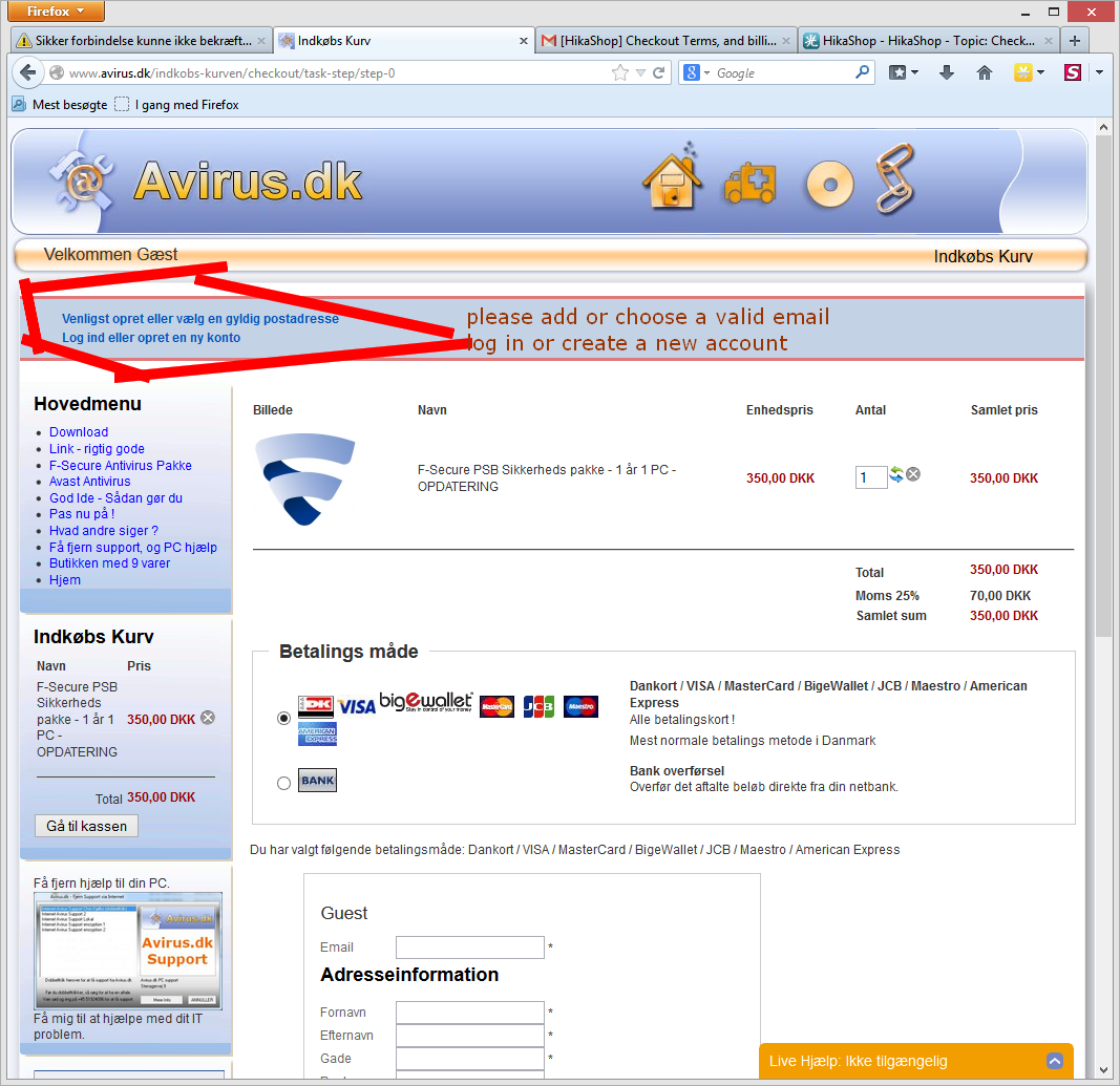

12 years 8 months ago #138387
I just tried to proceed to checkout through your website and when I register as a guest I 'm facing this error :
"Venligst opret eller vælg en gyldig postadresse
Log ind eller opret en ny konto

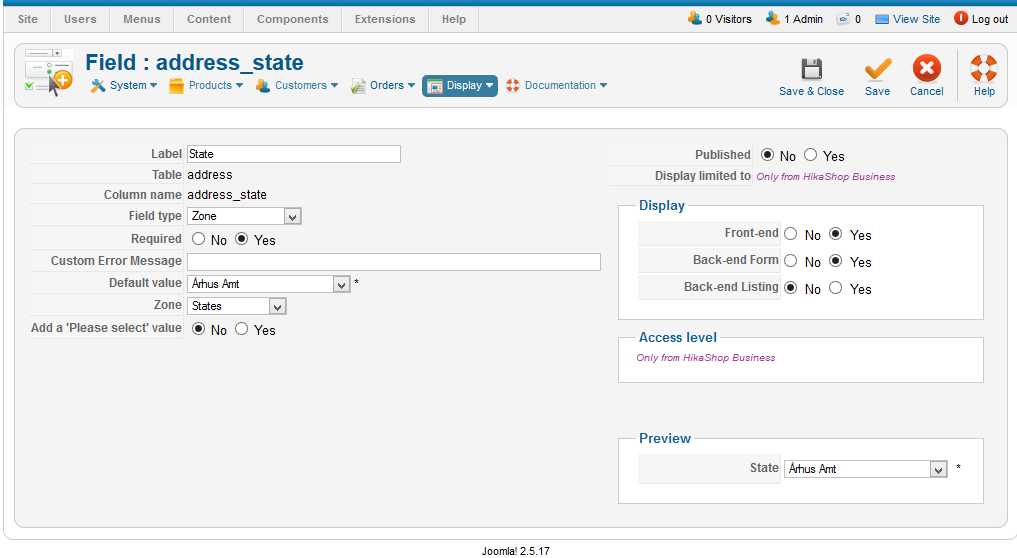

So I can't directly test your checkout process, did you edited some of your custom fields through "Hikashop->Display->Custom fields", also can you publish your "address_state" custom field ?

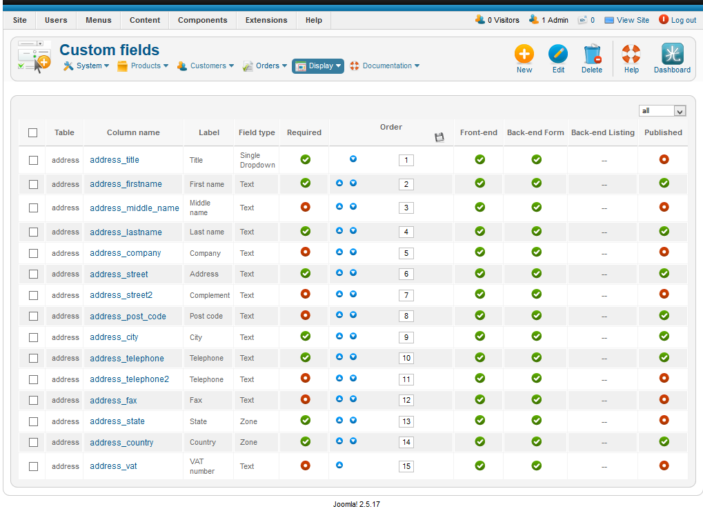

12 years 8 months ago #138399
Sure, and can you publish it ?

12 years 8 months ago #138406
Yes i can, but i don't want to have state enablet, i only sell to danmark ?
but i have now enablet "state" - when it works again, i have to disable State again.
but when i try again, the same happening,
Try for yourself, and try to change payment method, you get the same error emidealy ?

12 years 8 months ago #138435
The simple fix seems to be to hide the state field in the frontend thanks to some css properties.

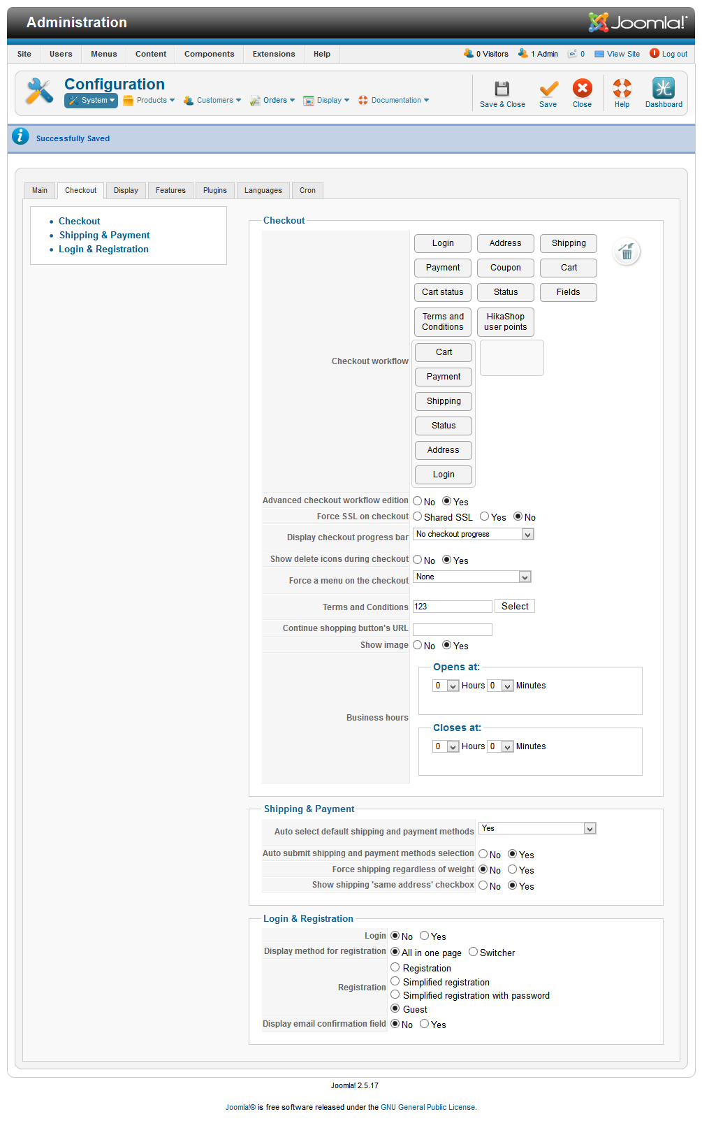

12 years 8 months ago #138788
I´m out in trouble.. :sick:
What can i do.. have tried to remove "terms and condition" and it still says : Please log ind, og create an account"
yo mate - you gotta help me :S i´m in deep here..
See attachment, thats my setting, and still it says, "Please add an account og choose a valid email (on line 1) log in or create an account (on line 2)"
Regards.
