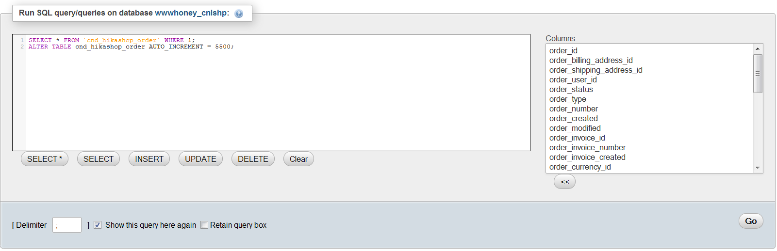

1 - I want to get my orders to start at 5500. After a few crashes I did the php adjustment "You need to go in the SQL tab and paste the query below there and click on OK. "ALTER TABLE jos_hikashop_order AUTO_INCREMENT = 10000; " Can I just change the 10000 to 5500?
(I had made a few errors in pasting/syntax earlier and orders stopped going through - Re-installing hika fixed it - but I am a little gun shy about messing it up again)

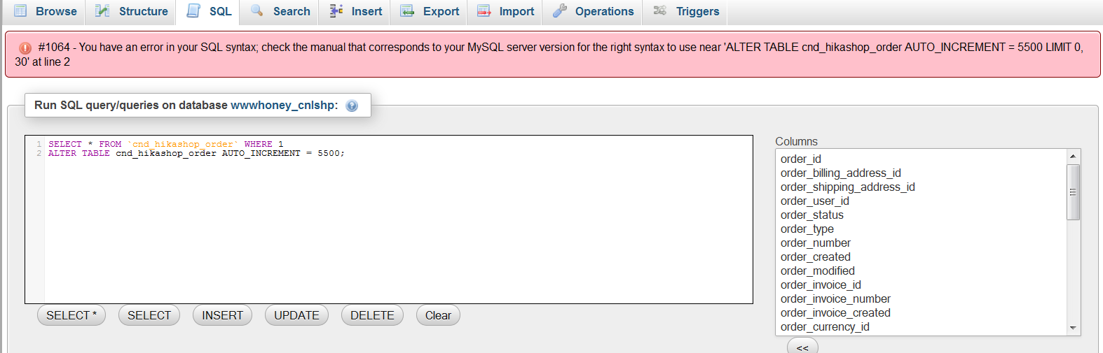

1 - I still have a problem. I previously changed it to 10000 ok. But here is screenshot of what I just did and the error.

12 years 8 months ago #138806
1. You have to add ";" at the end of the first line.

12 years 8 months ago #139009
Regarding #1 - I went to cpanel and entered "see the image" and hit "go", it seemed to accept it, with no messages on top like before (when I successfully changed it to 10000) - but it did not break site - still works, but not change in number on next test order.

  • Posts: 86181
12 years 8 months ago #139139
1. Remove the first line and it will work.
