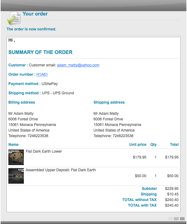

12 years 8 months ago #140046
Here is a pic. Also, i have setup tax rule for indiana sales tax only. WOrked for awhile but here is an order from Penn and VAT stills shows! Driving me nuts. Changed language overrides to TAX and it shouldnt even be taxing Penn. in the first place.

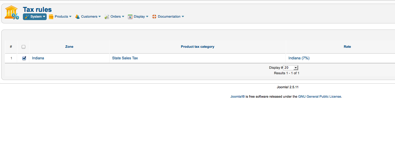

I'm not sure if you're saying that the issue is that customers outside Indiana are taxed when they should not, or if the issue is that the customers see the tax in the emails while they don't see it in the checkout, or if the issue is that the text VAT is shown in the email notifications although you changed it in the translations (actually I do see it correct in your screenshot, so it must not be that).
If customers outside Indiana are taxed when they should not, it means that your tax rule(s) is not configured properly. We would need a screenshot of your tax rules listing to be able to say more on the issue.

I just did a just on your website and I do see the "indiana" state in the state field of the registration form, along with all the other states of the USA. However, I don't see the tax applied to the prices even though my address in now in Indiana which do means that something with your tax rules is not configured properly. As I said in my previous message, we would need a screenshot of your tax rules listing to be able to say more on the issue

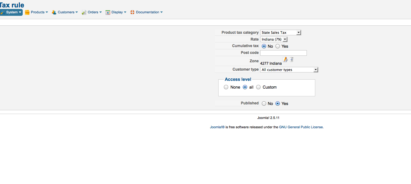

12 years 7 months ago #140683
1. Are you using an Indiana billing address through your checkout process ?
2. Can you check that the "Product tax category" option of your products is correctly set to "State Sales Tax"
  • Posts: 28
12 years 7 months ago #140775
Yes.
They were set to "default tax", I am changing them all to "Sate Sales Tax" now.
  • Posts: 86181
12 years 7 months ago #140898
So it should work now right ?
Because you need to have the same tax category in your tax rules and in your products, otherwise, the tax rules won't apply to your products.
