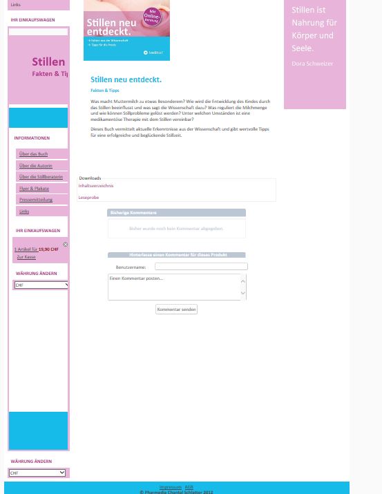

-- url of the page with the problem -- //http://www.stillbuch.ch/index.php/shop
-- Joomla version -- : Joomla! 2.5.17
-- PHP version -- : 5.3.3-7
-- Browser(s) name and version -- : Firefox, Explorer
When I test the shop and add an item to the cart, the cart showsup very strange, it contains part of the website. I don't know how to get rid of it. Thanks for your help.

For a strange reason, when you are updating the cart, it calls an url ( /shop/product/updatecart/tmpl-component?from=module&product_id=13&cart_type=cart&quantity=1&add=1&Itemid=490&return_url=L2luZGV4LnBocC9zaG9wL2NoZWNrb3V0 ) and this url gave a "HTTP 303" to redirect the call to the checkout.
It is the reason why you see the checkout page in a part of your website.
Logically, you should have a "HTTP 200" and see the content of the cart module.

Turn off the "Use AJAX when possible for add to cart buttons" option of the configuration and that should solve the issue.

Thank you, perfect!
