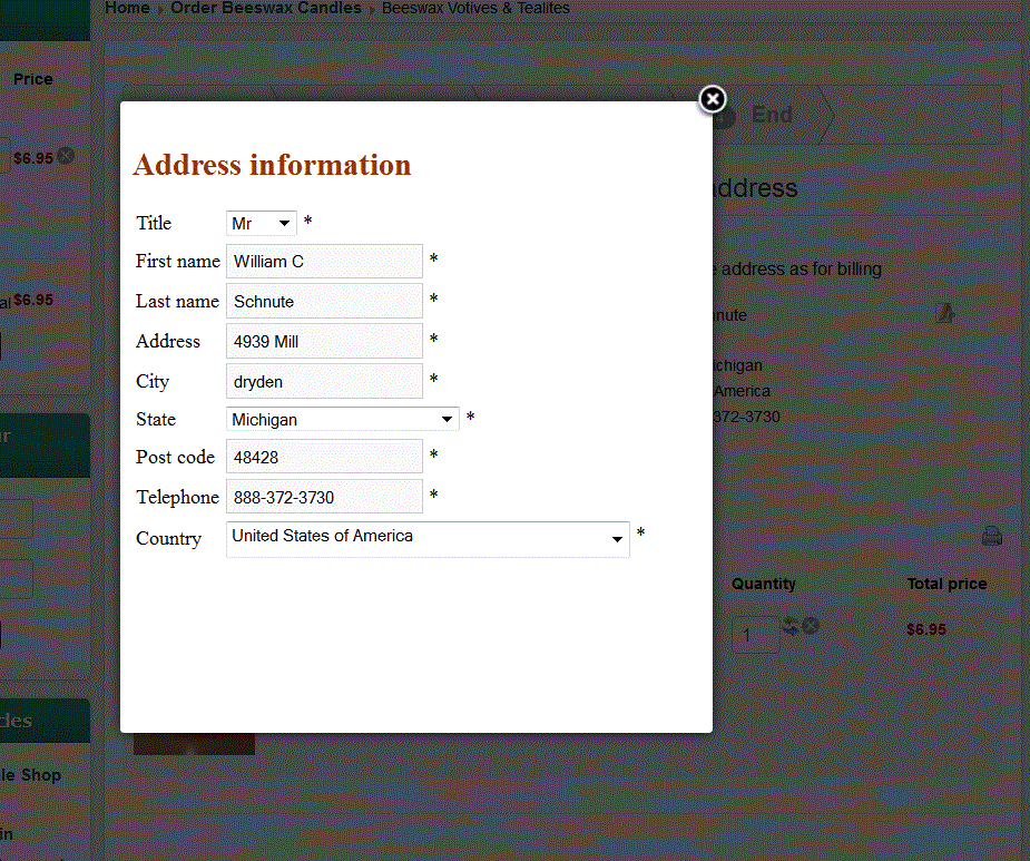

After entering address and going to next page, If I want to change the ship to address, the popup always comes up perfect, but there is no “ok” or “submit” or anything on the pop up to make the program accept it. How do I fix this? I think is was working in the past.

I checked and have made no changes to the "address" view of the front-end template. I have removed all shipping plug in"s and payment plugin's and re-loaded a fresh copy of hikashop with no change.

There is no way that the button is not displayed by HikaShop. Either the button's code
echo $this->cart->displayButton(JText::_('OK'),'ok',$this->params,hikashop_completeLink('address&task=save'),'if(hikashopCheckChangeForm(\'address\',\'hikashop_address_form\')) document.forms[\'hikashop_address_form\'].submit(); return false;');
has been removed in the file "form" of the view "address" via the menu Display>Views, or the code around altered, or the cart helper's displayButton function has been modified, or there is a system plugin which removes the HTML of the button on your website.

I still cannot get the popup to work showing “OK” or something to make the program accept it. If a customer wants to ship to another address, or worse, makes a mistake in entering their own address, THERE IS NO WAY FOR THEM TO CHANGE IT – other than wait a few days.

Hello - I still have not resolved this "Ship to another address" problem and it is becoming very troublesome for our customers.
I cannot make any of the “ship to another address” selections work.
The “dropdown” selector will give a “403error” when I change the shipping address.
The “list” selector - both have checked box selected and I cannot change it. – If I change the shipping address the billing changes to same thing whether the customer wants it or not.
The “popup” selector – opens nice popup box, but there is no “submit” button or anything to make it work.

Regarding the popup not displaying the submit, either your template is overriding the view or a system plugin/template option is removing it. Because there is no way that HikaShop is not displaying that button.
Check the folder templates/YOUR_TEMPLATE/html/com_hikashop/address/ for any view override and if so try to rename the folder in order to deactivate the override.

Thank you for your help. I created a test site with akeeba backup and copied my site to it. I did eventually find a plugin called "seo renderer' that was causing the problem. I now remember that this same plugin was causing an issue on our other site with the same template.
Popup works fine now.
