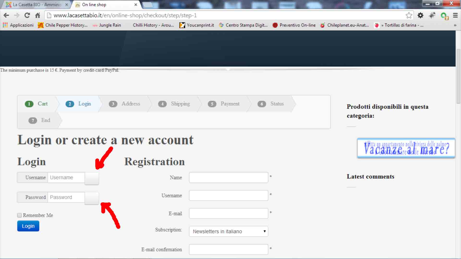

-- url of the page with the problem -- : lacasettabio.it
Today i discovered a new graphic issue also.
During the check out, on login step
there are 2 anonimous buttons.
They are "forgot user name" and "forgot password"
You can see them on my screenshot
How can i give a name to the buttons?
my site with Hikashop
www.lacasettabio.it
12 years 7 months ago #142864
I just tested it and It's working fine on my end, the solution will probably be to directly edit the code of the "login_form" file of the "checkout" view of your front-end template through the page "Hikashop->Display->Views"
  • Posts: 719
12 years 7 months ago #142892
I've checked my template> ceck out> login form
I have any overwrite
I did not have this issue before i enable the bootstrap design.
www.lacasettabio.it
Last edit: 12 years 7 months ago by lacasetta.
  • Posts: 26386
  • Thank you received: 4078
12 years 7 months ago #142916
It means that your template is not fully compatible with Boostrap.
It does not embed the bootstrap icons.

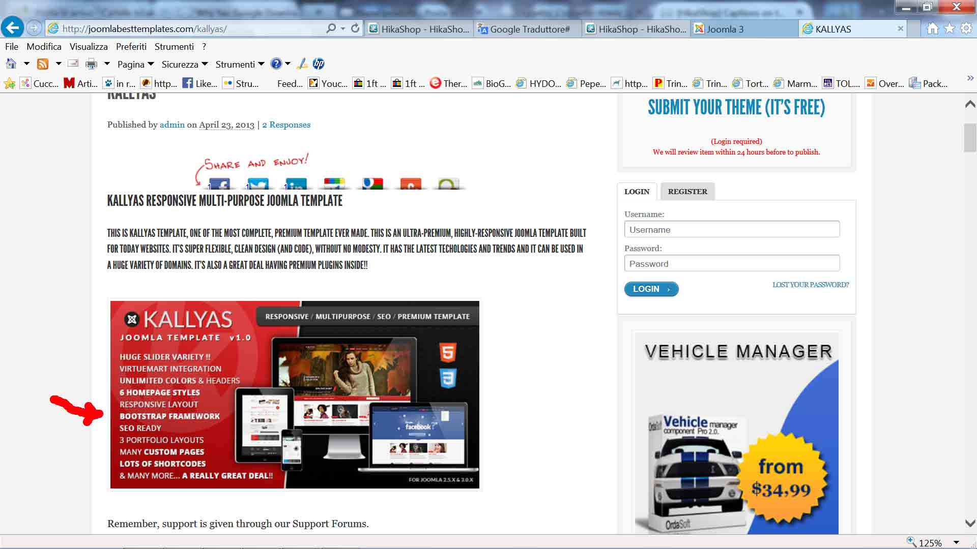

  • Posts: 719
12 years 7 months ago #142952
as you can see on my screenshot my template uses the bootstrap framework.
So, how can we fix that, please?

  • Posts: 719
12 years 7 months ago #142955
I look for my template and i find that it manage the class
.icon-question-sign
www.lacasettabio.it
  • Posts: 26386
12 years 7 months ago #142987
Does it really support the icon-question-sign ?
I do not see any "background-image" for the style "icon-", which is generally
background-image: url("../img/glyphicons-halflings.png");
And without background image, you can't have an image.
I am sorry but even if it is written that the template use the bootstrap framework, it does not handle the bootstrap icons.
