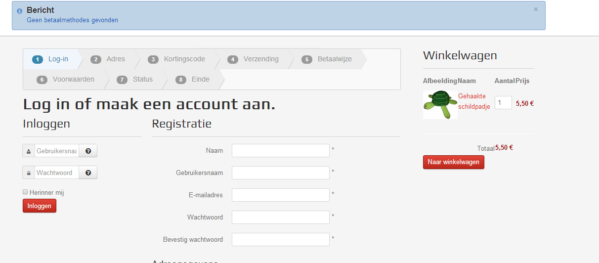

I have a question about the checkout cartstatus
- is it possible to rename it because in the front end the module name is fully written, see pic, i just want to rename it to status only
- is it possible to change the position of login and register, i want login above register instead of side by side.
Thanks, michel

1. Your can rename it by adding a translation override like that:
HIKASHOP_CHECKOUT_CARTSTATUS="Cart status"
2. You can change their position like you want as explained here:
www.hikashop.com/support/support/documen...tml#registration_box

Another problem that i need to solve is that the terms and condition page is opening in a wrong module postion, there is no more popup with the related terms and condition article, but the article opening in i think the footer of the page
Also i am a bit lost with with the cart module
I have in the side bar the plugin with newest article and add to chart
When the customer wants to check out and pay its still there, i am just looking for the option to show only the checkout page without newest article and other stuff in the sidebar.
(think those are silly questions but iam a bit lost, sorry)
Thanks in advance
  • Posts: 86181
12 years 7 months ago #143137
If the Terms & Conditions popup doesn't display properly it means that there is a problem with the support of popups by your joomla template. You can try the different values of the "Popup mode" option of the configuration and there should be one which works fine with your template.
If you don't want the side bar cart module or other modules to display on the checkout, you can use the "menu assignment" option of each module to not display it on the menu item of your checkout that you can select in the "force menu on checkout" option of the hikashop configuration.

Stil i dont understand where to change the layout of the hika shop checkout page, when i start to check out i dont want the side bar with the module add to chart. (for the cutomer i prefer page with only the hika shop checkout page
see attachment "winkelwagen at sidebar 2 , that one has to go when people go to checkout
