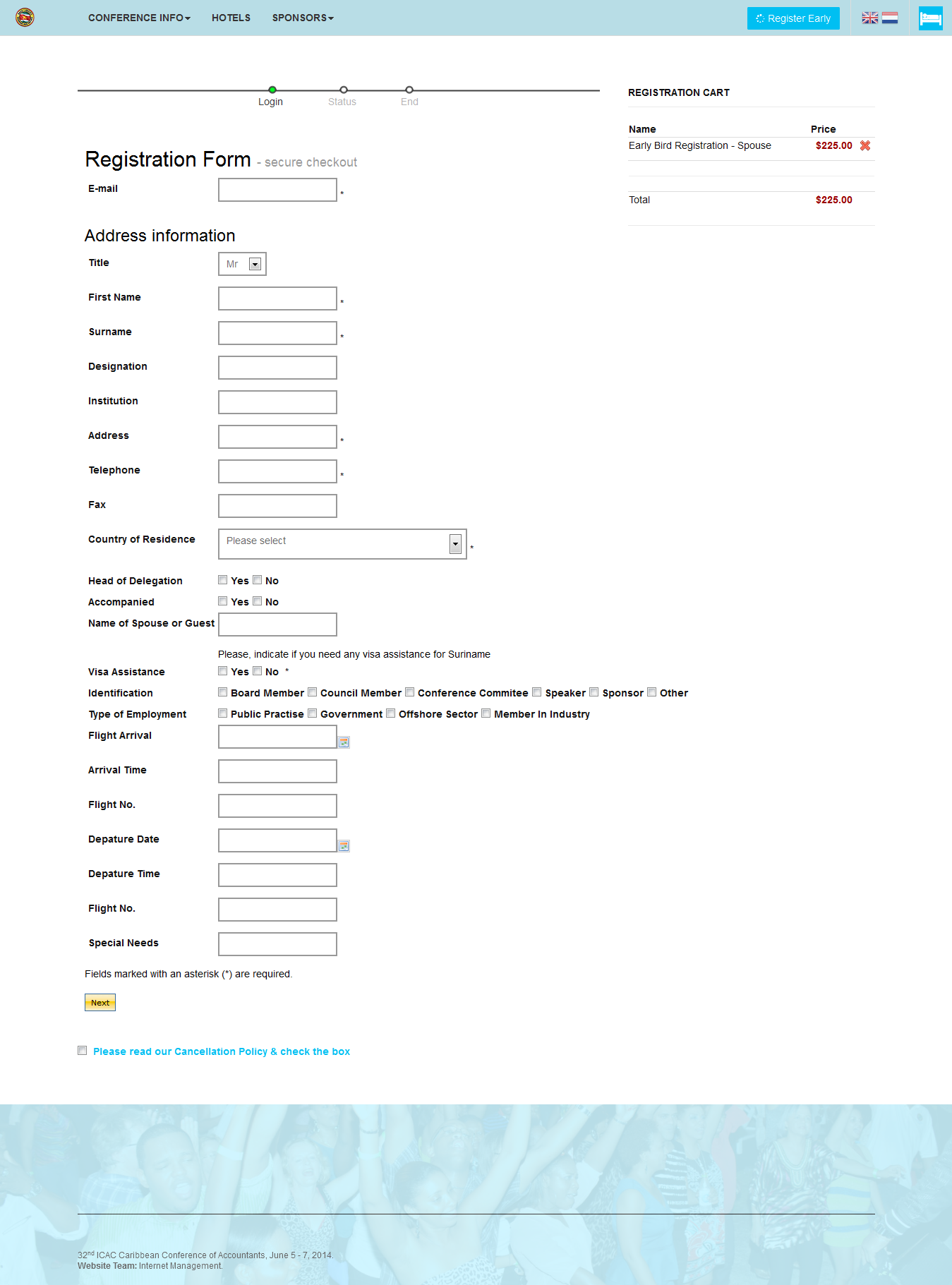

Our site is for an event (a Conference) and there are three member categories (Non-member, Member & Spouse) with three differing price for each (No Registration to Joomla/Hikashop required). Each event attendee is required to select their preference, fill in the form (we used custom fields to develop) and pay. See demo: 2014conference.icac.org.jm/index.php#page-158
(1). The problem is whether you select Non-member, Member or Spouse, there is just one form for an attendee to sign-up and then pay. Spouse needs a separate form and then pay. How can this be accomplished?
As the site is near completion we just would like a separate form for Spouse with different fields than the original form.
(2). If I cannot add another form for Spouse, how can I develop the current form so that the Non-member or Member form can add the price of $225 for their Spouse if selected. Please help, I really like Hikashop and been using since 2011.

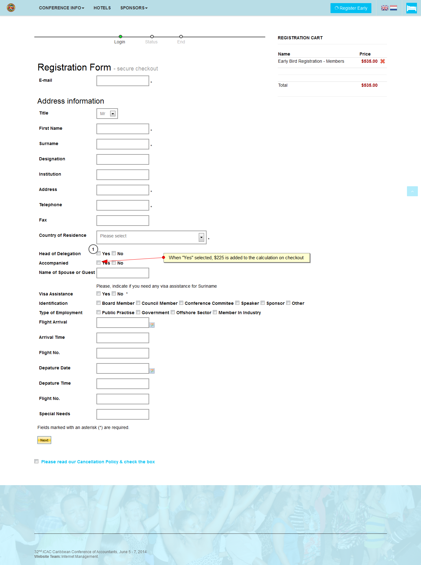

When I set it up, I do not see the fields or the new form on the Product page. See my test page I set up with your instructions ( 2014conference.icac.org.jm/android-2.html ). There are no fields there. And when I click on "add to cart" I get the same form.
Let me try to explain a little more clearly. I wish to have 2 different checkout forms. The one that is currently there (hf85a1b0.png, it appears after you click on the "add to cart" link) and another form with different fields, when you click on another product.
If that cannot work, then how can I develop the current form so that the checkout form can add the price of $225 to the existing calculation if "Yes" is selected. See image attached (ha3f9095.png)

  • Posts: 86181
12 years 7 months ago #144041
This is the registration form, it displays on the checkout not on the product page and thus it is common to all the products.
I'm talking about the product page which is where you see the add to cart button. there, above the add to cart button, you'll see your custom item field after you create it and you can have there different fields for different products.
