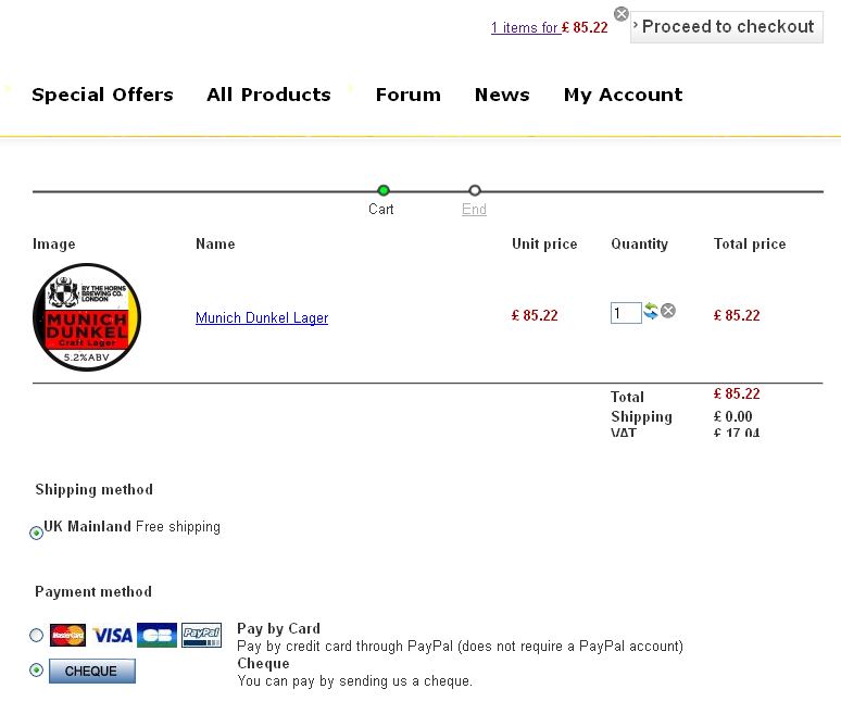

I am using the latest version of Hikashop and I seem to have discovered what seems a bug.
If I am on the Checkout page with the Cheque option selected, if I press the X next to the Proceed to Checkout to clear the cart, instead of clearing it you are taken straight through to the payment successfully completed page.
Is anyone able to replicate this bug or is this an issue with my site?

I didn't succeed in reproduce the bug in local. By the "X next to the Proceed to Checkout", you mean this button, right ?
Can you send me a link to your website so I can test by myself and see what's going on ?

I've got business edition 2.2.3, I will update to the latest version first thing on Monday.
I do mean that button correct. I am attaching a sample of how my page looks. I think I've got a 'get around' by moving the Paypal option up in the hierarchy so the cheque option is no longer the default option. I won't ask you to do a test now as I'm finishing up for the weekend, but it might also be worth noting I am using Firefox.
