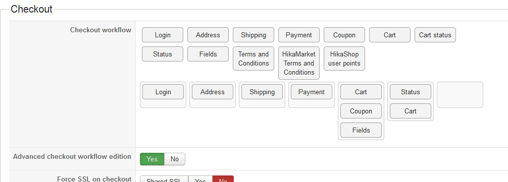

I have just updated to Hikashop 2.3.0 from 2.2.0 and now the checkout won't go past the Address step.
My settings are:
Any ideas?

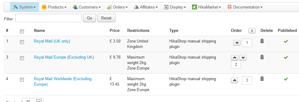

I have downloaded again and installed but the problem persists.
Here is my shipping methods:
Trevor

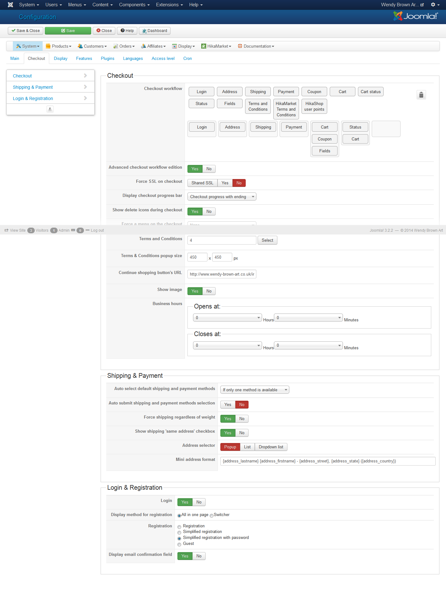

Could you check that your template able to display system messages ( www.hikashop.com/support/support/documen...tibility-issues.html ) and could you also provide a screenshot of the rest of the options of the Checkout tab of the configuration ?

12 years 5 months ago #145265
The display does show system messages but I switched to the Beez template and tried the checkout but no messages were displayed.
Here are the full settings for checkout tab:
