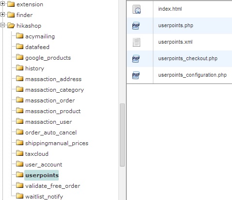

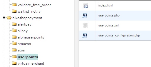

OK...in my Control Panel I have found these 2 plugins and am ready to update the .php
My question is...
For the Hikashop user points, which file do I alter?
And for the Hikashopuserpoints, which file do I alter?
  • Posts: 26386
  • Thank you received: 4078
12 years 6 months ago #146189
"userpoints.php" in both folders.
You will find two lines with the part of code I pasted. Please be careful to just replace the code I pasted with the other code block, do not remove more content, do not replace the all line.
You can do a "search & replace" with the exact content if you want..
