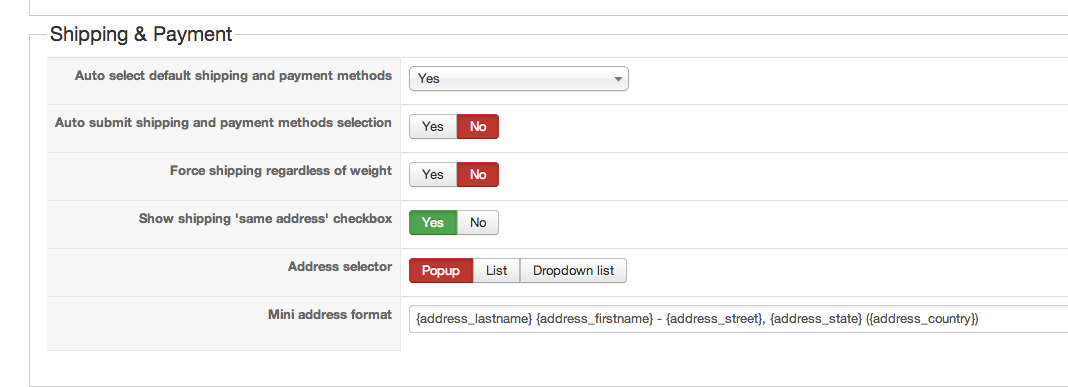

  • Posts: 172
12 years 6 months ago #146268
just look
