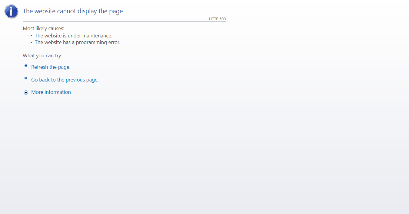

I am able to create an error if I have no weight determination in my product, but then I am not able to select a shipping address, it just defaults to the billing address. But when I am able to create an order it opens an HTTP 500 Internal Server Error page instead of an order confirmation page. I do receive an email confirming the order though. Strange.

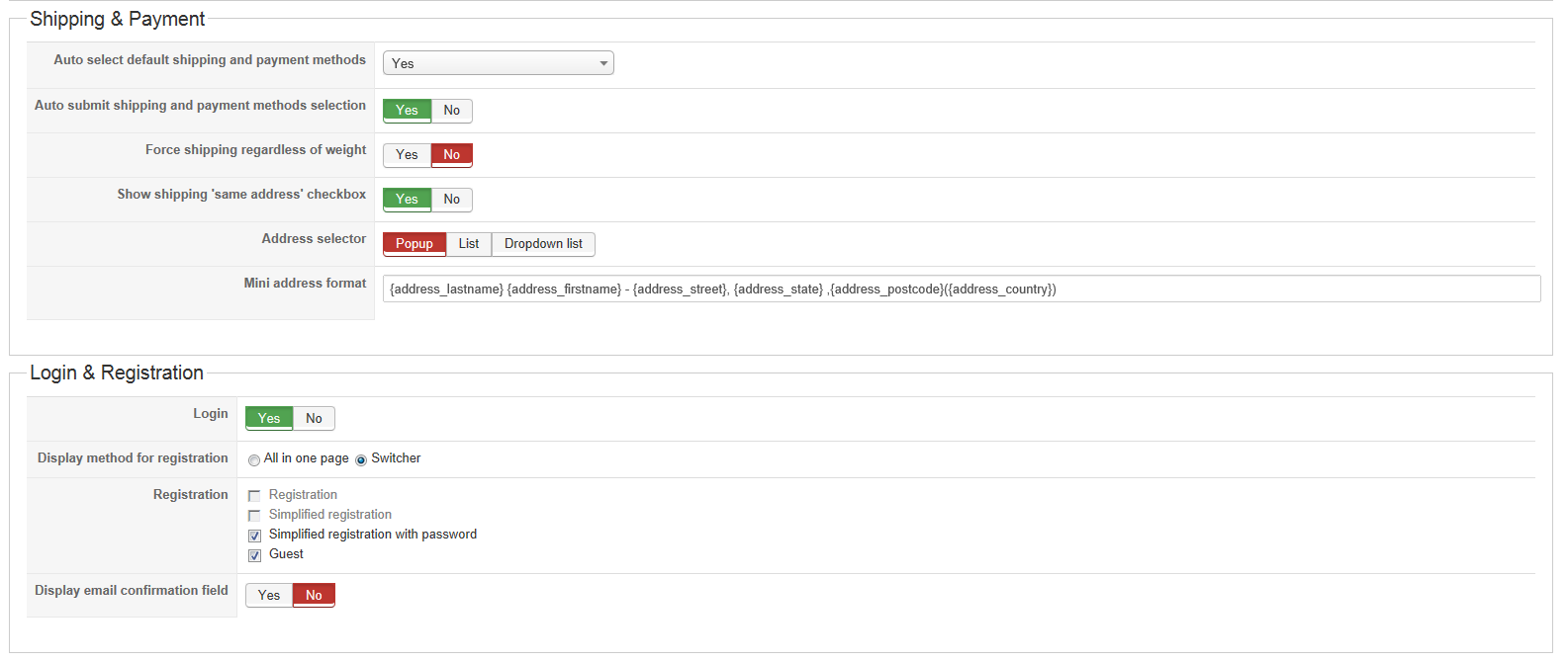

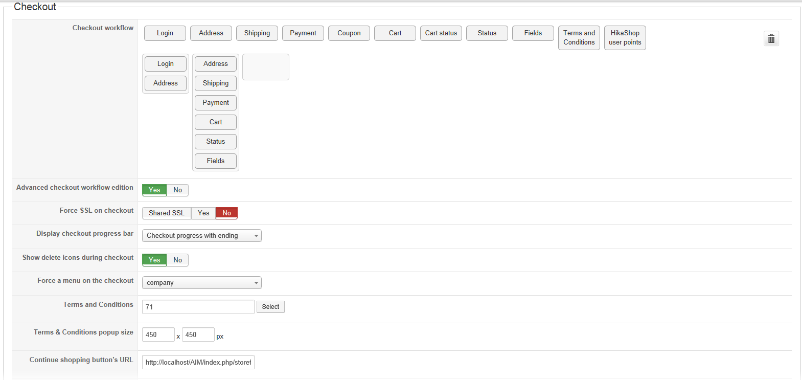

I have read that there is a "Confirm" step or layout in the Checkout workflow, but I can't seem to find that. I am attaching some screenshots for you so you can maybe help me out.
I thank you advance for your support.

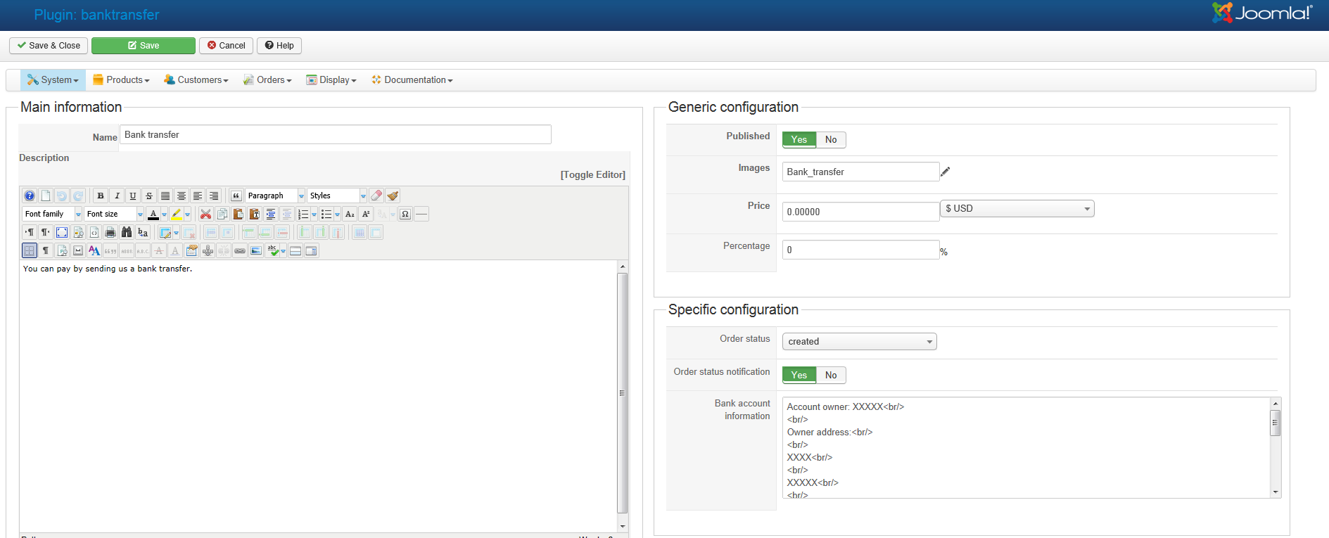

12 years 6 months ago #147077
Ok, and can you tell me how did you set the "Order status" option of your bank transfer payment method ?
  • Posts: 39
12 years 6 months ago #147203
Order Status: Created
Order Status Notification: YES

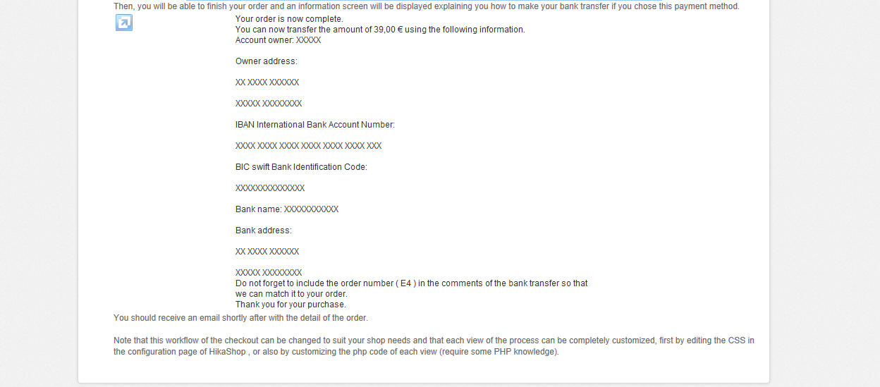

I actually tried changing the order status to None to troubleshoot but I still don't have an order confirmation page. I used to get a confirmation as the attached until I upgraded....

Without an access to your website it will be difficult to tell you.
You may have a PHP error somewhere which stop the order processing just after the order creation (and before the emails).
At this moment I will recommend you to check the PHP error log or activate the debug more (with the "error reporting" set to "maximum" in the Joomla global configuration).
Like that, without seeing anything directly, it will be difficult to find the problem.

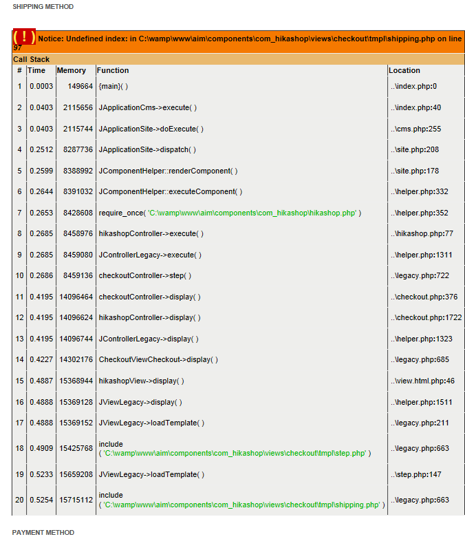

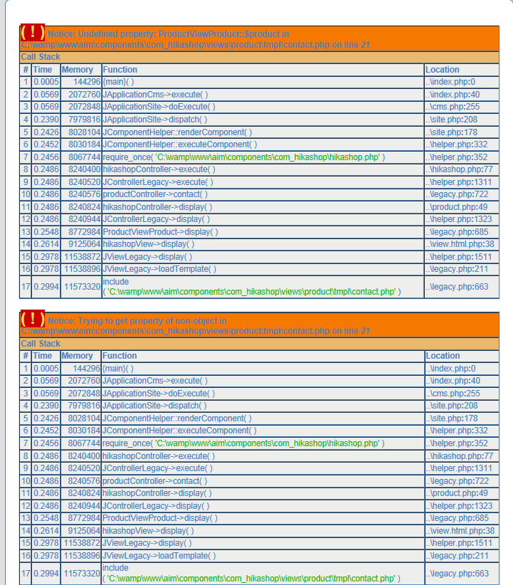

I have activated the debug feature in Joomla. I have found one error in the contact page, but I would doubt it has something to do with this. I have attached the two different screens.
How do you access a website on a personal PC/localhost? I really could use your help, please.

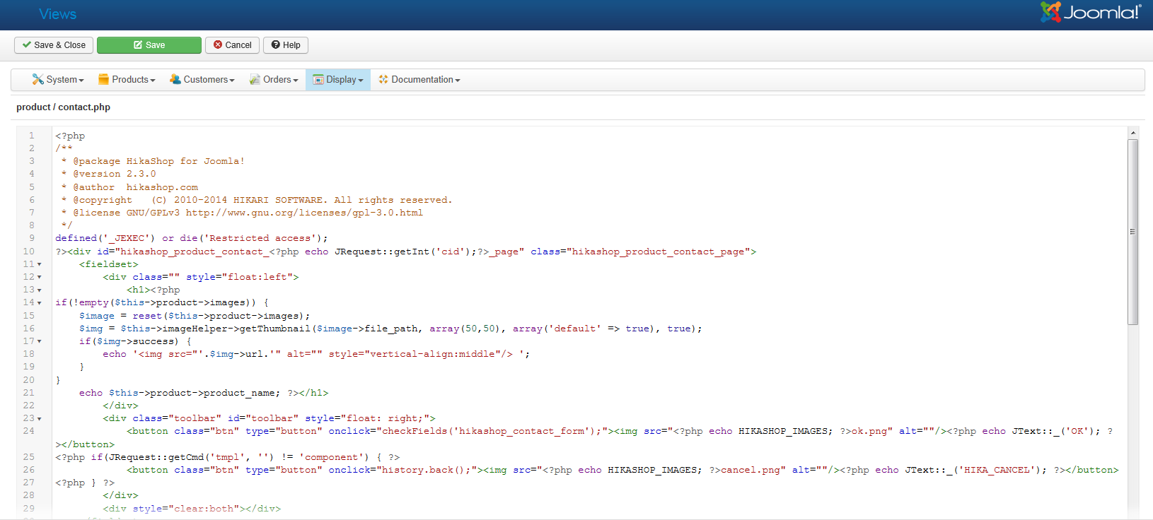

12 years 6 months ago #147919
Hello Ann,
These errors are coming from the file "contact" of the "product" view of your front-end template, did you done some modifications through that file via "Hikashop->Display->Views" ? If that's the case, removing your customization or correct it will probably solve your issue.
  • Posts: 39
12 years 6 months ago #148025
The only modifications that I made were to the address_template file putting the postcode/zipcode after the state to be consistent with the US template. There was no customization to be removed for contact file in the product view. Any other ideas?

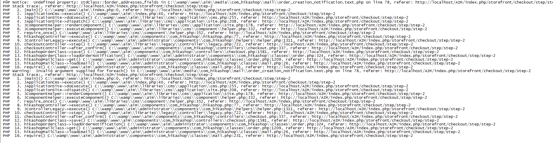

12 years 6 months ago #148052
I found an error log. I imagine this is the php error log to which you were referring a couple of posts above? I think I am in big trouble. Looks like address issues? Can someone please assist me?
Thanks,
Ann
  • Posts: 26386
  • Thank you received: 4078
12 years 6 months ago #148256
The log show warning in the emails.
We will see the source of these warning and fix them. There is no big issue with warning, it's not a fatal error.
So that does not explain your "500" error page.
Please understand that without an access to your website, we can't help you as we wanted to.
You need to reproduce the error page and see the PHP fatal error which create this error page.
You can also use another browser than IE, like Firefox, to see the real content returned by your website and not the generic "500" page.
