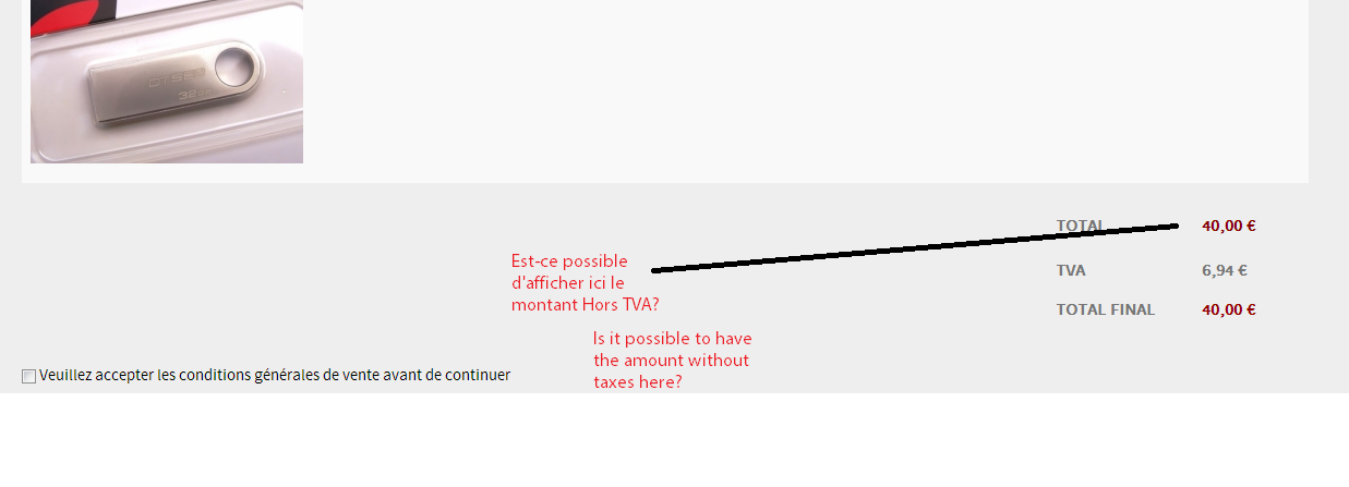

On the chackout page, i have Total and Total final and both sows the same amount.
Is it possible to have Total whithout taxes and Total with taxes on the checkout summary
I submit a screenshot where you can see much more about the trouble.

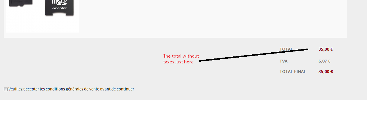

I already have tested this way but my wish is to have on the product page the price with taxes included and on the checkout total area, the price without taxes. You can see on the screenshot attached.
Thanks a lot for you answer.
Greatings.
