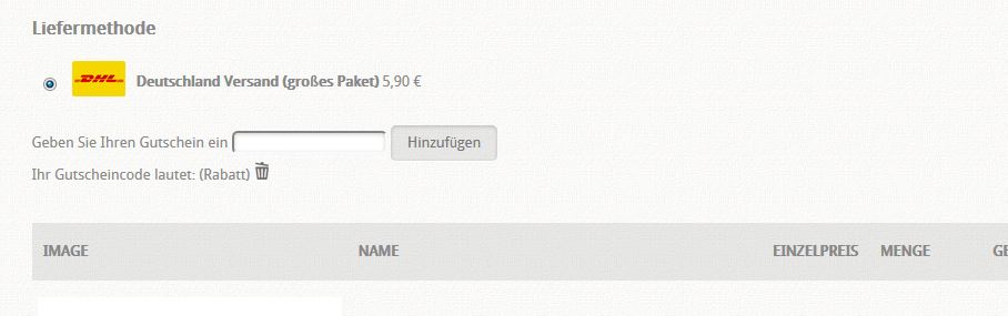

12 years 5 months ago #149663
Hi Mohammed,
Just to show you what I mean please see attachment. As there is no title or spacing for the coupon code, it seems to be part of the shipping field. Giving it a title would help customers who in the past say they have not seen this.
12 years 5 months ago #149651
Sure, you'll just have to add something like this at the beginning of your file :
<fieldset>
<legend>Add your coupon</legend>
And this at the end of your file :
</fieldset>

12 years 5 months ago #149866
Mohammed - that's perfect. Thank you.
