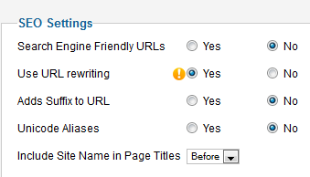

Can you try to disable the SEF on your website to see if that solve the problem ?
  • Posts: 17
12 years 5 months ago #150049
I needed to change the first 2 options, and rename .taccess.txt to .htaccess. and it works on also on internet explorer.
But is this a problem from joomla or is it from my webserver?
