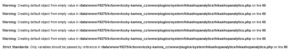

The system said this warning:
Warning: Creating default object from empty value in /data/www/19275/krbovevlozky-kamna_cz/www/plugins/system/hikashopanalytics/hikashopanalytics.php on line 65

The next warning which I see is:
Strict Standards: Only variables should be passed by reference in /data/www/19275/krbovevlozky-kamna_cz/www/plugins/system/hikashopanalytics/hikashopanalytics.php on line 80

The strict standar error is on the line 80 (the file was opened in Dreamweaver).
On this line I see this:
$currencyInfo=reset($currencyClass->getCurrencies($currencies, $null));
So no "&" symbols there which should be removed.
The lines with erros 5x the same + the error of strict standards, see attachement:
