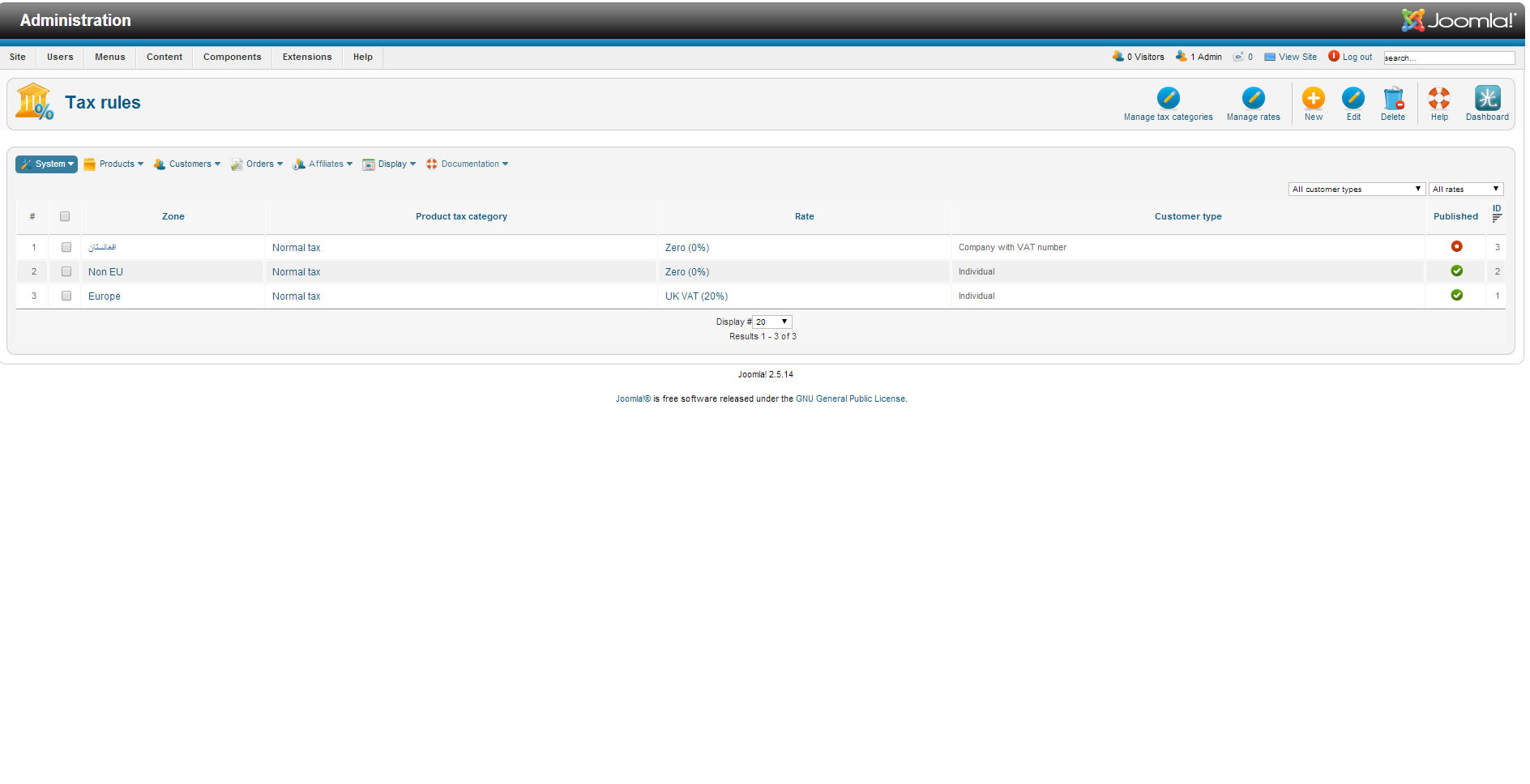

Now a bit of a strange one, I have only just noticed but the tax is incorrect for some countries. I don't understand why.
What I have done, I have all the countries within the EU (European union) listed in the zones as "Europe" with this zone having the Tax code set at 20%. Now when I do a test of Germany it lists it as tax at 10%, Iceland it lists as no vat. The UK it lists as 20%.
I have the main tax region within the configuration set as zone "Europe"
I don't understand.
If you can help I would be very grateful.
Yours
Iain

We would need more precise information on your setup in order to help you.
Could you provide a screenshot of your tax rules ?
  • Posts: 234
  • Thank you received: 4
12 years 5 months ago #151618
Hello
I hope this helps.
Yours
Iain
12 years 5 months ago #151644
Thanks to check if there is no countries not desired in your Non EU zone, and that all the desired countries are present in the Europe zone.

12 years 5 months ago #151857
Hello
That is the case, only the countries which are in the EU are within the EU zone.
Yours
Iain Gwynn

12 years 5 months ago #152158
I am not sure where the 10% tax rate comes for some countries, such as Ireland, Iceland has no tax at all.
It is all very confusing.
Iain
  • Posts: 234
12 years 5 months ago #152260
Yeah all fixed. My issue was that I didn't need a Non EU zone, because by default anything not in a zone is classified as zero rated.
Cheers
