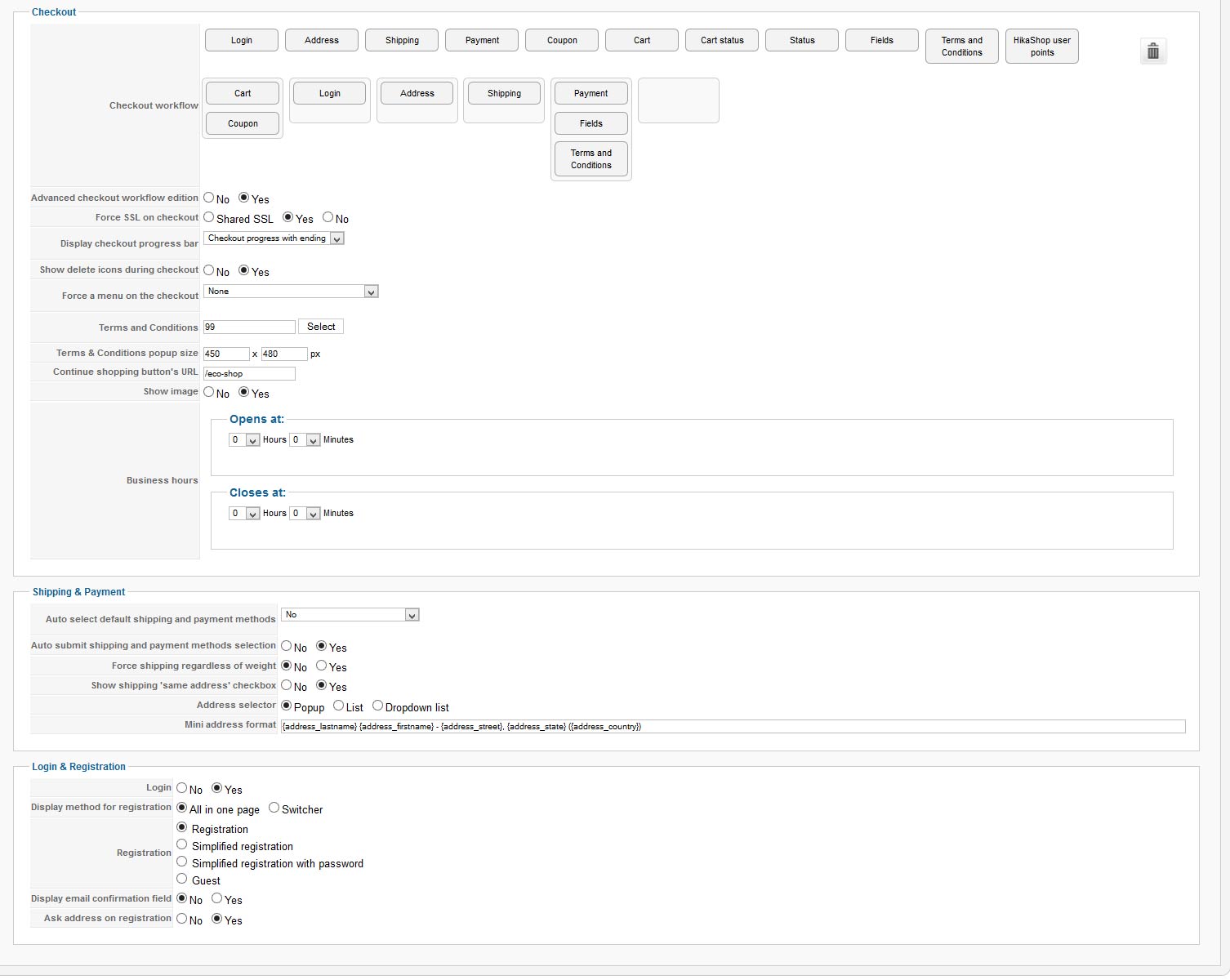

Could you give us screenshot of your checkout configuration ?

  • Posts: 301
12 years 5 months ago #152133
I have done tests and I can't replicate any problems.
Seems the majority of problems is creating user account and it not letting you do that.
screenshot attached
12 years 5 months ago #152574
Could you try to disable the option "Ask user address on registration" or put the address step in the same clumn than the login one ?

12 years 5 months ago #152586
I have disabled Ask user address on registration. I have gone through checkout without a problem so it works for me - hopefully it will work for other customers. What does disabling this do as I can't really see much change.
