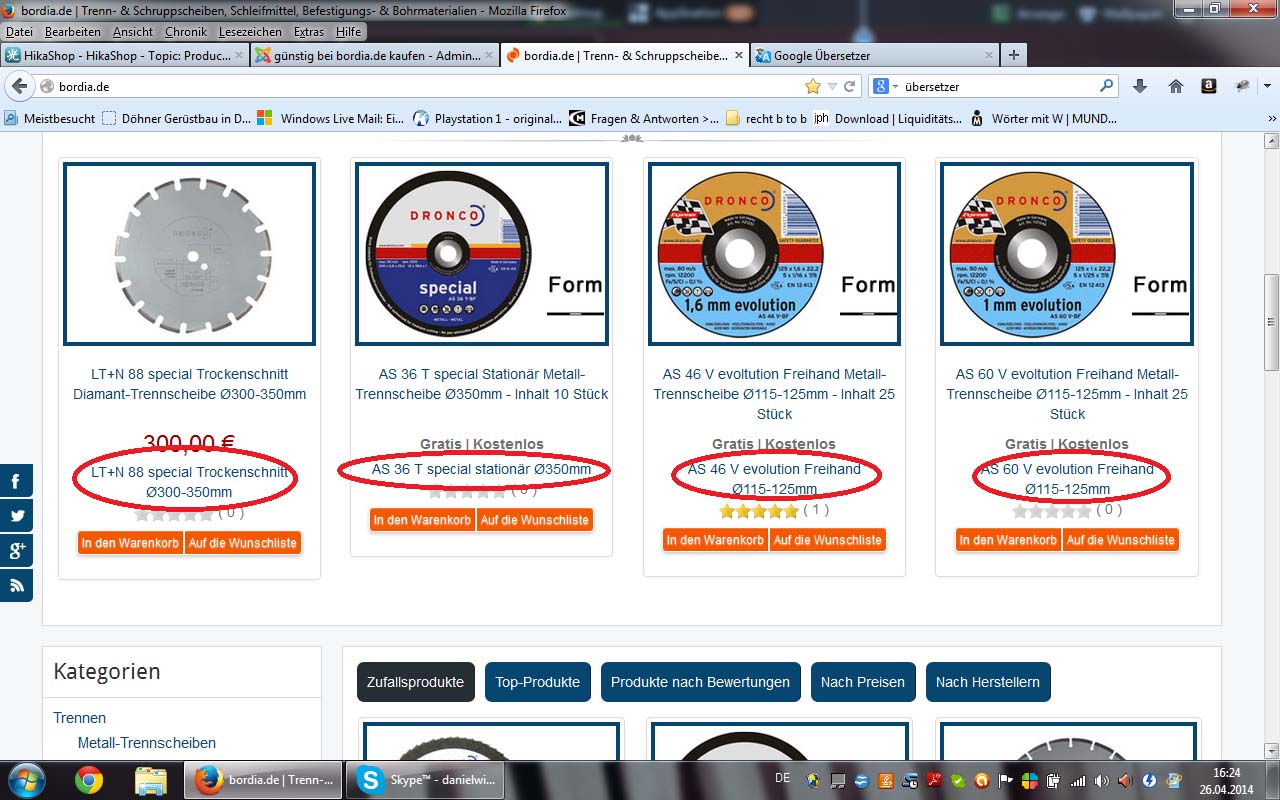

  • Posts: 81
12 years 3 months ago #153674
I have the display of the product code in the configuration reactivated. So that is the product code shown on the invoice.
My question is, how do I get the product code does not appear in the Product category.
In the picture marked in red.
Best regards
12 years 3 months ago #153807
You have to edit the view "product / listing_img_title" and remove the product code part.
<!-- PRODUCT CODE -->
	<span class='hikashop_product_code_list'>
		<?php if ($this->config->get('show_code')) { ?>
			<?php if($this->params->get('link_to_product_page',1)){ ?>
				<a href="<?php echo $link;?>">
			<?php }
			echo $this->row->product_code;
				</a>
			<?php } ?>
		<?php } ?>
	</span>
<!-- EO PRODUCT CODE -->
  • Posts: 81
12 years 2 months ago #154576
Thank you very much! The way I want it.
