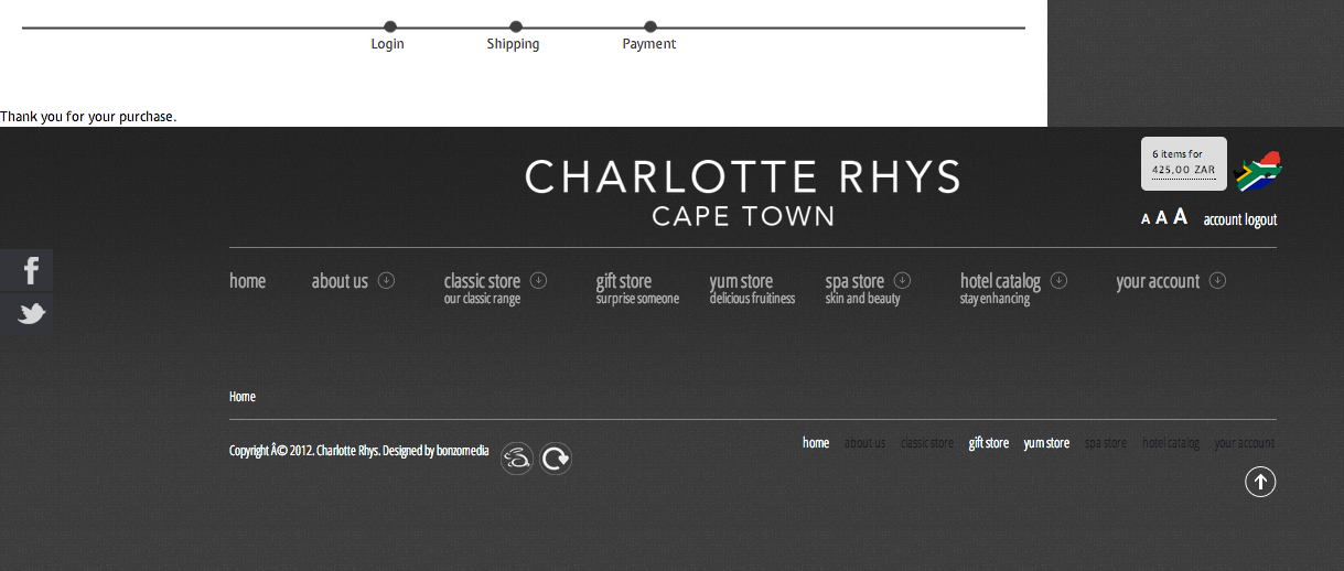

Have a problem with my end of checkout page breaking the template and appearing at the top of the screen.

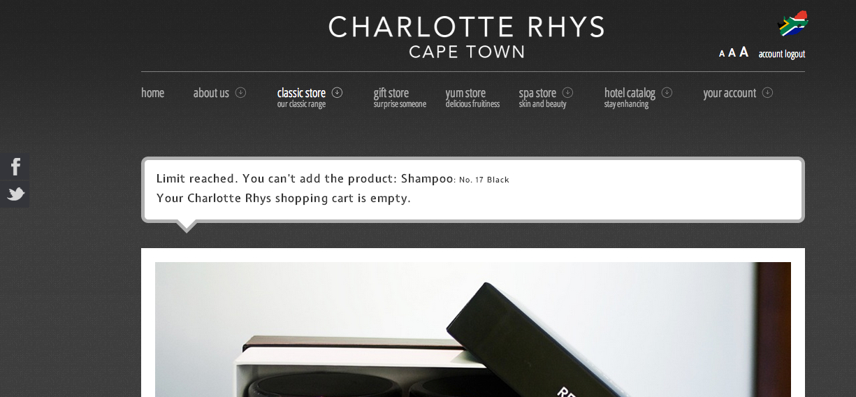

Also, once the order has been completed and I return to a product page I get an Empty cart message (which is fine) along with a "Limit Reached" error (which is not fine!).

Screenshots attached showing the problem.

I seem to experience the same problem of 'thank you' message appearing in no module position somewhere on top of the header after the completion of the checkout process. The text in the footer area also appears with strange characters. Need to resolve this since it will confuse customers or make them anxious. Thanks
