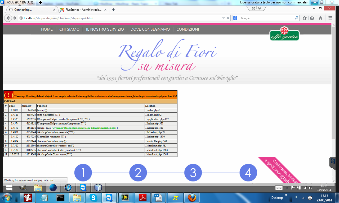

The user is redirected to product listing view with empty cart message. Then, choosing again the product and redoing the checkout steps, another order is created. Now, as before the modifications, I have the warning in the attached image.
It's caused by $order->customer->email. Customer is null in order class, save method. This could not be a problem.

If you mean the problem reported in the attached image, it's not an error: it's a warning. Line 358 of order.php as the image reports, in HikaShop Starter 2.2.3 version.
It's caused by an evaluation of a null object: customer. This happen when you try to write customer email on order class, in the save method.

Could you give us the corresponding line of the error warning ?
The full line could help us.
