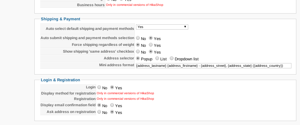

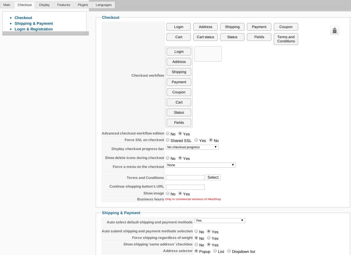

12 years 3 months ago #158427
Thanks to give us screenshot of your checkout settings in order to try to reproduce the issue on our end.
The following user(s) said Thank You: roseline
  • Posts: 7
12 years 3 months ago #158552
As attachement below
