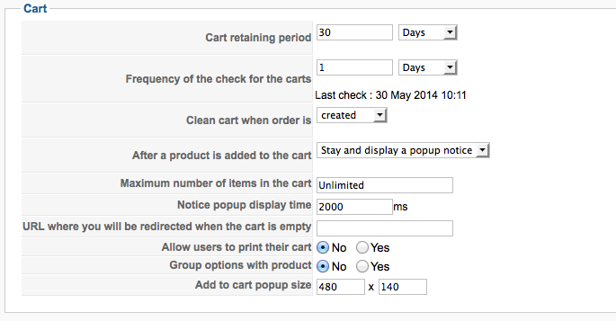

  • Posts: 37
12 years 3 months ago #158624
1. I dont have the Joomla! cache plugin enabled. I tried clearing my broswers cache as well as tried other browsers and it still isnt functioning properly.
2. I have the pop up enabled yes, it works just fine from the product table. It just does not work correctly from the main product page.
3. I didn't have to add any custom code as this works correctly from the table. I does not work correctly from the main product page as well.
Abstract Image Group | Fulfilling all of your large format printing needs!
  • Posts: 2334
  • Thank you received: 403
12 years 3 months ago #158661
That's strange, you don't have any JS error.
Could you post a screenshot of the configuration with the "After a product is added to the cart" option?
You might also try to disable some plugins that are playing with th redirection if you have any.
  • Posts: 37
12 years 3 months ago #158772
Yes it is in fact very strange, it seems to function perfectly fine anywhere else on the site, its just the main product page.
