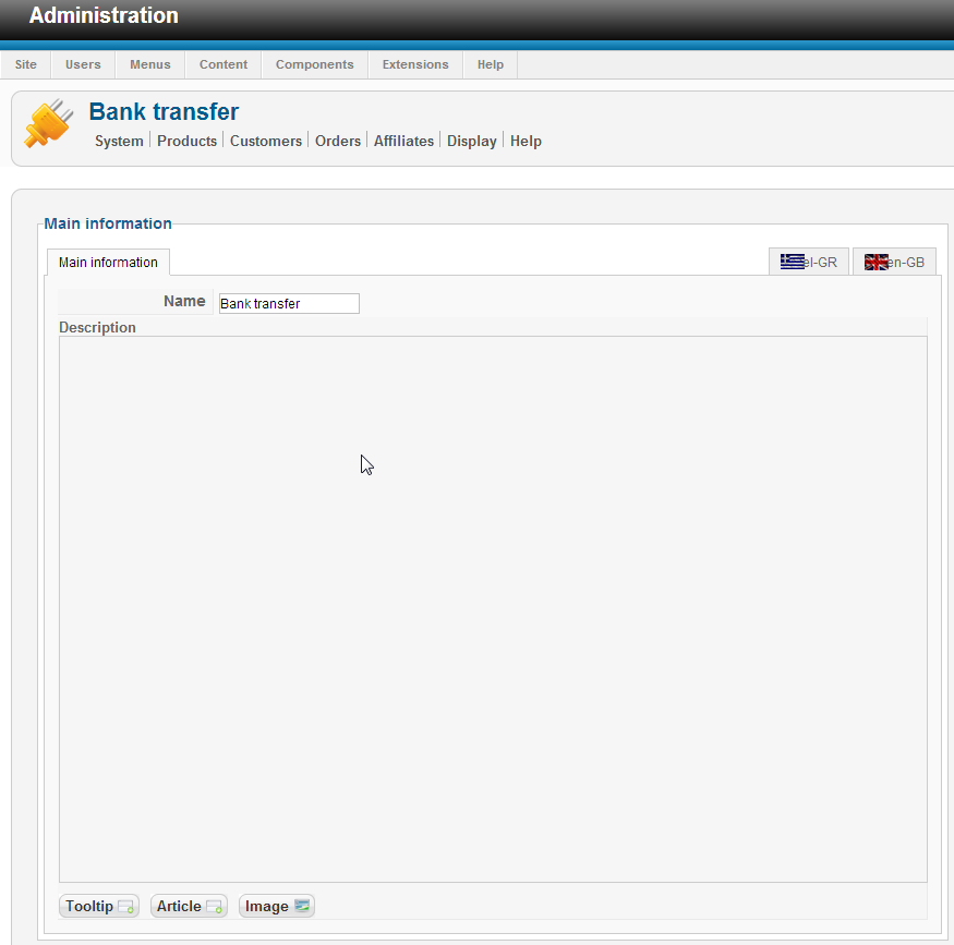

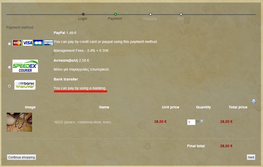

just one more quick question. Where do we edit the Payment method description?
take a look at the screenshot, I have underlined it in red.
12 years 3 months ago #159588
Via System > Payment method edit the desired payment method and replace the content of the description part.
  • Posts: 68
12 years 3 months ago #159674
Hi, I've looked there before. That is the wierd thing.
It doesn't allow me to edit this description and there is nothing there.

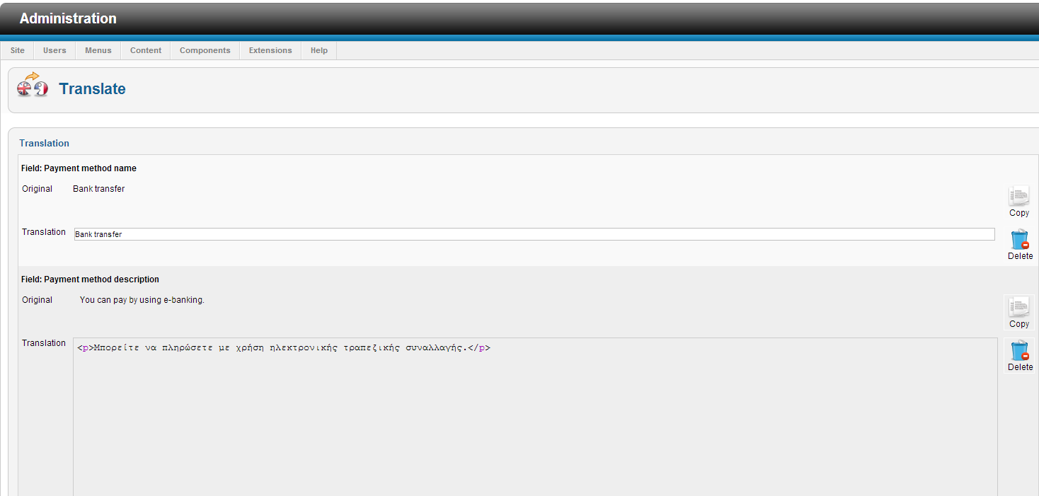

Look at the tabs with the flags added by falang.
In the falang translation, the description in english is there, but cannot be edited. Only the translation can be added. :oops:
  • Posts: 86183
12 years 3 months ago #159680
This looks like a bug of the HTML editor.
Go in the configuration of HikaShop and change the "editor" option to something else and try again.
  • Posts: 68
12 years 3 months ago #159768
that did it
thanks (I had codemirror in my profile which I prefer)
