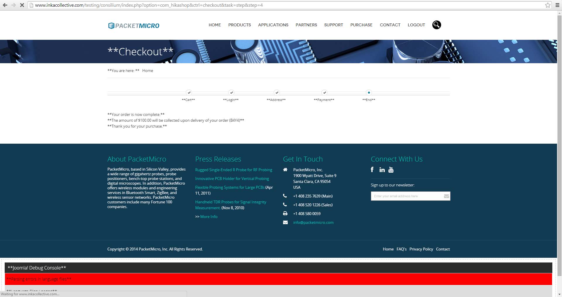

Not sure if this is a Hikashop issue or a sh404sef issue. After I complete an order the page goes to the correct thank you page, however after a second it redirects to a 404 error page. I can actually see the correct thank-you page display on screen but then it is quickly replaced with the other one. Please help, if you can.

12 years 3 months ago #160896
Yes, it still redirects to product-listing.html after I turn off sh404sef. I have narrowed the problem down to the payment methods, in the payment methods the option for "cancel URL" is the page that is redirected to. This is not correct as it should stay on the thank you page.

12 years 3 months ago #161028
I cannot copy and paste it, the redirection happens too fast but I have included a screenshot of the page before the redirection. Also, the problem may be the after_end view however the back-end does not show any changes have been made to it.
*update/edit. I removed the url from the "Return URL" field in the Payment Method and that solved the problem. However, what is this field supposed to do, do I need it for anything?
Last edit: 12 years 3 months ago by rodopemu.
12 years 3 months ago #161069
Indeed you had to empty that field.
This field is needed if you want a redirection, so in your case you had to let it empty.
