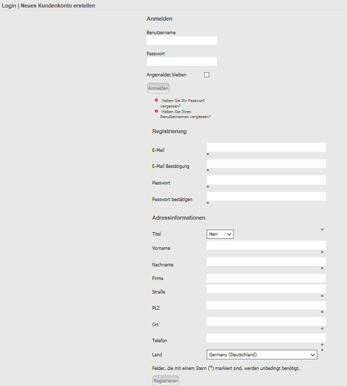

Hello!

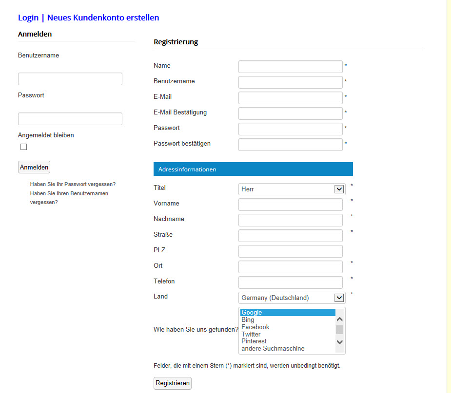

I dont find a way to design my checkout / adress page like this sample i found in the web.
Could someone give me a hint how to design the page like the sample attached.
I have attached my current "not nice" checkout page where the Login is before/above the registration fields. I would have the Login fields left side and the Registration fields right, on the same height beginning......
Thanks in advance!
Best regards,
Chris

Thanks for your replay. So i looked at checkout / login.php and found this code. As i understand this, it should work in that way i would like it. Login and Registration side by side. but at the Moment in my shop Login and Registration are shown one above the other. i dont know why?
<div id="hikashop_checkout_login" class="hikashop_checkout_login row-fluid">
<?php
if($display_login) {
<div id="hikashop_checkout_login_left_part" class="hikashop_checkout_login_left_part span4">
<fieldset class="input">
<h2><?php echo JText::_('HIKA_LOGIN');?></h2>
<?php echo $this->loadTemplate('form'); ?>
</fieldset>
</div>
<?php } ?>
<div id="hikashop_checkout_login_right_part" class="hikashop_checkout_login_right_part span8">
<h2><?php
if($this->registration[2]) {
echo JText::_('GUEST');
} else {
echo JText::_('HIKA_REGISTRATION');
?></h2>
<?php

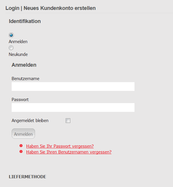

@update
i use another solution now, i use the Switch for "Login" and "Registration" - so only one sections shown. - still like it better
the only Thing i would prefere is to make the "Registration" radiobutton active by Default, not the "Login" radiobutton. i m seaching a while but i cant find the correct place to do this.
could someone give me a short code peace for activation the Registration radiobutton by Default.
thanks
Chris

The two columns are potentially due to your template which is overriding some properties.
For example, if it is adding margin on the elements so the width is maybe too high to keep the elements one next to the other one.
So you have potentially to reduce the element's width with a property like:
.hikashop_checkout_login_left_part{width: 30% !important;}
.hikashop_checkout_login_right_part{width: 60% !important;}
To change the default selected value, you have to edit the view "chekout / login" and change the value of the variable "$defaultSelection" to "0".

Hi!
I have changed "checkout / Login" - the variable "$defaultSelection" to "0". (line 16)
But the default Button which is always first checked is the "Login" Button, but not the "Register" Button - nothing has changed....

So you need also to add such code in the checkout/login view :
<?php
$js ="
var radioBtn = document.getElementById('data[register][registration_method]1');
radioBtn.checked = true;
displayRegistration(radioBtn);";
$doc = JFactory::getDocument();
$doc->addScriptDeclaration($js);

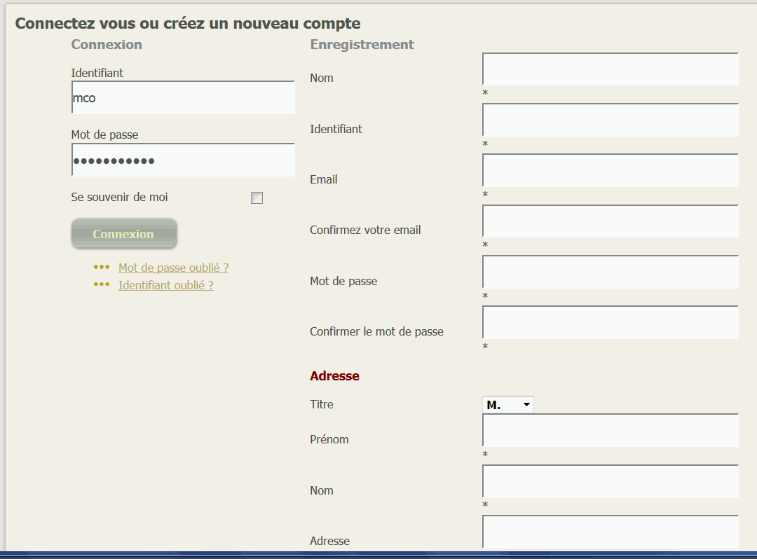

Sorry for my "poor" message! I was too much in the subject of the topic!
I put you 2 attachment files where you can see
- what I have ( checkout2 in french) and
- what I would like to have (checkout1 in german)....
And I am no able to write php alone, just copy...
Have a nice day
Marietek
Last edit: 12 years 1 month ago by marietek. Reason: wrong explications!

12 years 1 month ago #167745
It is done thanks to option "Display method for registration" in the HikaShop configuration (tab "checkout").
But this option is only available in commercial edition of HikaShop (essential / business).
www.hikashop.com/support/support/documen....html#checkout_login
