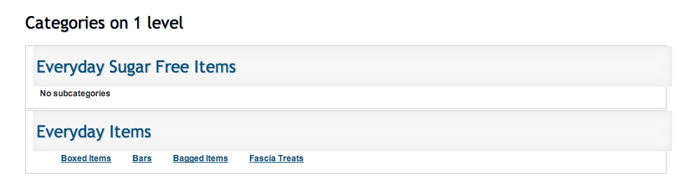

Since my last post I figured out how to enable it on the front end, but instead of having all categories and subcategories appear, I wanted it more like a drop down menu with an indicator on what category or level you are on.
Any way I can edit the modules css to change the look and add a hover and drop down? (I have attached a screen shot of how it looks now)
12 years 2 months ago #163636
To display it as a dropdown, you will have to edit the view "category / listing_list".
It will require a lot of changes in that view ;) HTML changes, CSS will not be enough.
