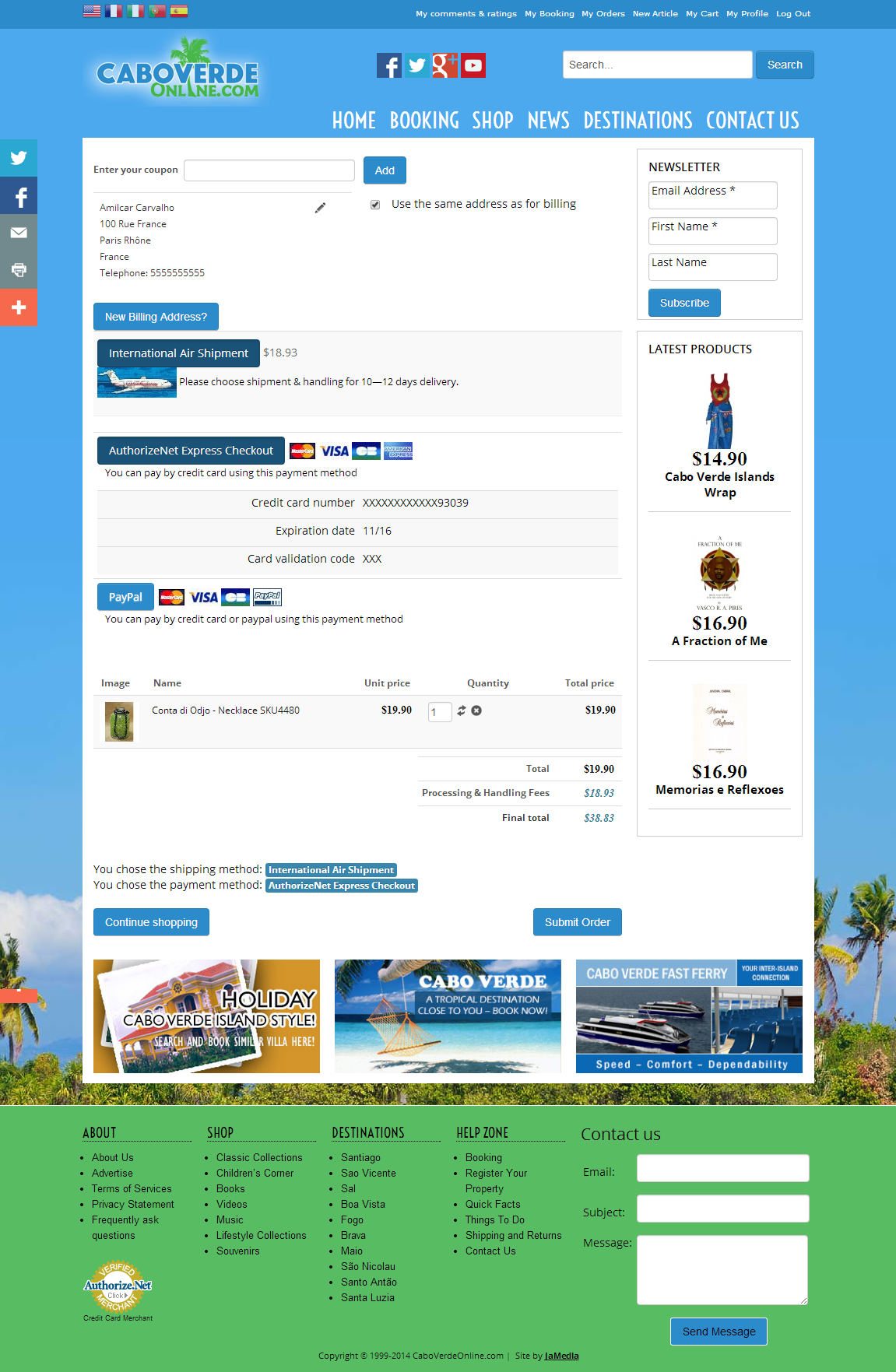

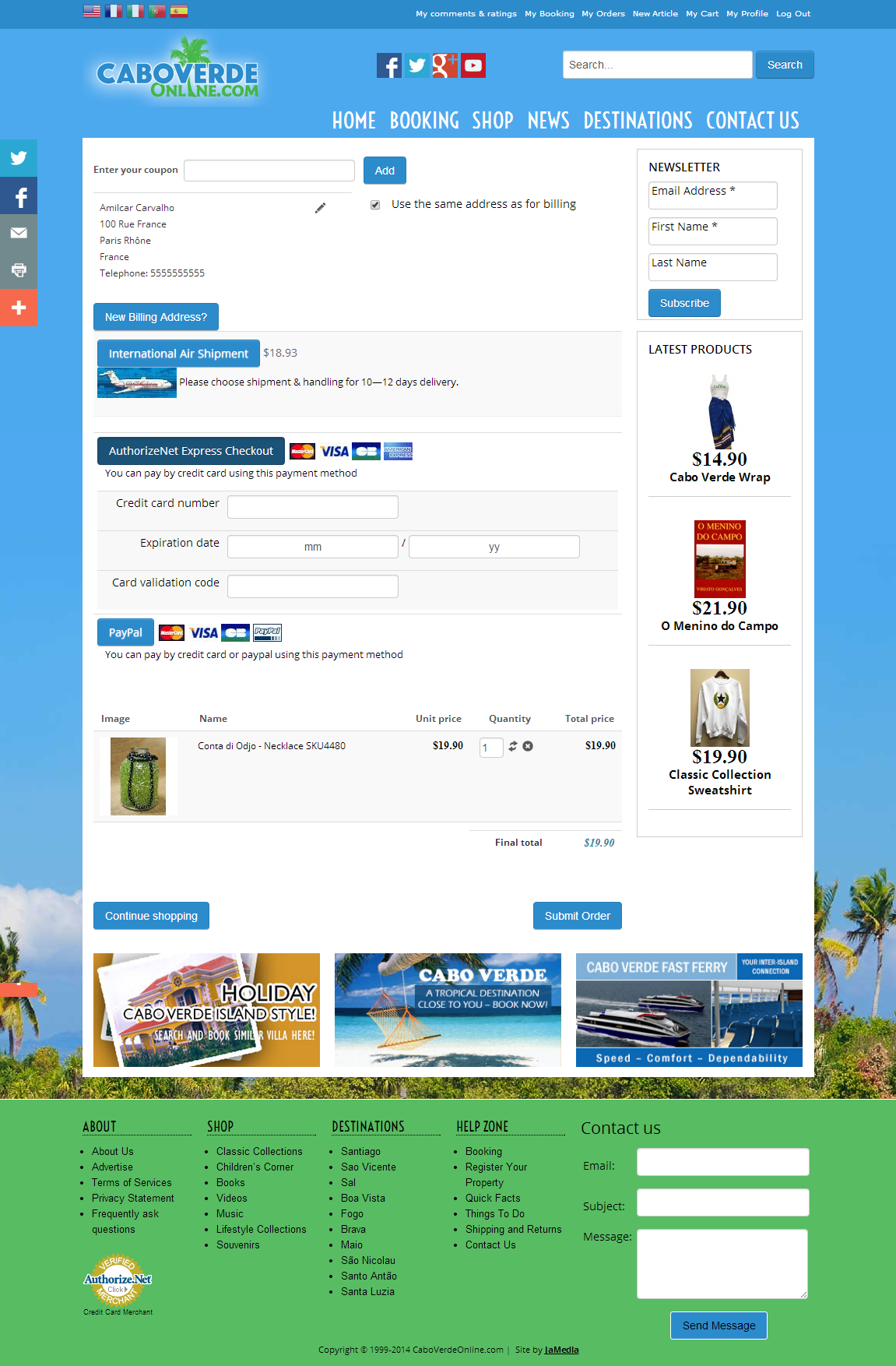

I notice that someone has to press submit order button twice to complete the order.
Step 1: After adding your credit card information you have to click the submit order button.
Step 2: It adds your card to the page and you have to click the submit order button for the second time for the order to go through.
To a lot of people after step 1 they'll expect that their order has been submitted . I would like to change the first button to say confirm order and then on step 2 to say submit order, or for the order to be submitted after you click the submit button for the first time.
I attached a screen shot which shows the 2 steps. I would appreciate the help.
Thank You.
11 years 11 months ago #165840
A solution can probably be to set the "Auto submit shipping and payment methods selection" option through "Hikashop->System->Configuration->Checkout".
