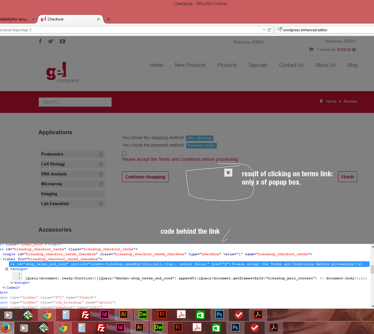

I can't figure out why the link for my terms and conditions is <a href="#"..............
I have selected and article from the setup form and the article ID shows up under my checkout settings.
Seems like every time my client asks for a change to checkout flow, the change I make doesn't work. I like a lot of things about Hikashop, but I've spent weeks trying to get a checkout flow to work in a very straight-forward manner.

  • Posts: 33
11 years 2 months ago #201029
Sorry -- should have given more info. Since I've posted so often lately I just figure everyone knows me :oops:
-- Joomla version -- : 3.4.1
-- PHP version -- : 5.3.29
-- Browser(s) name and version -- : Chrome latest
My current setting for the popups is "mootools", but I have tried others with no results.
I've tried putting the terms in various places of the checkout flow, and I've tried changing out different article ID's to make sure it wasn't something on the article page.
Based upon previous conversations, it sounds like it could be a javascript error... but the popups work for all other parts of checkout (address change for example).... so I'm not sure what the issue is. I will send private message with URL.
thanks,
jerry
