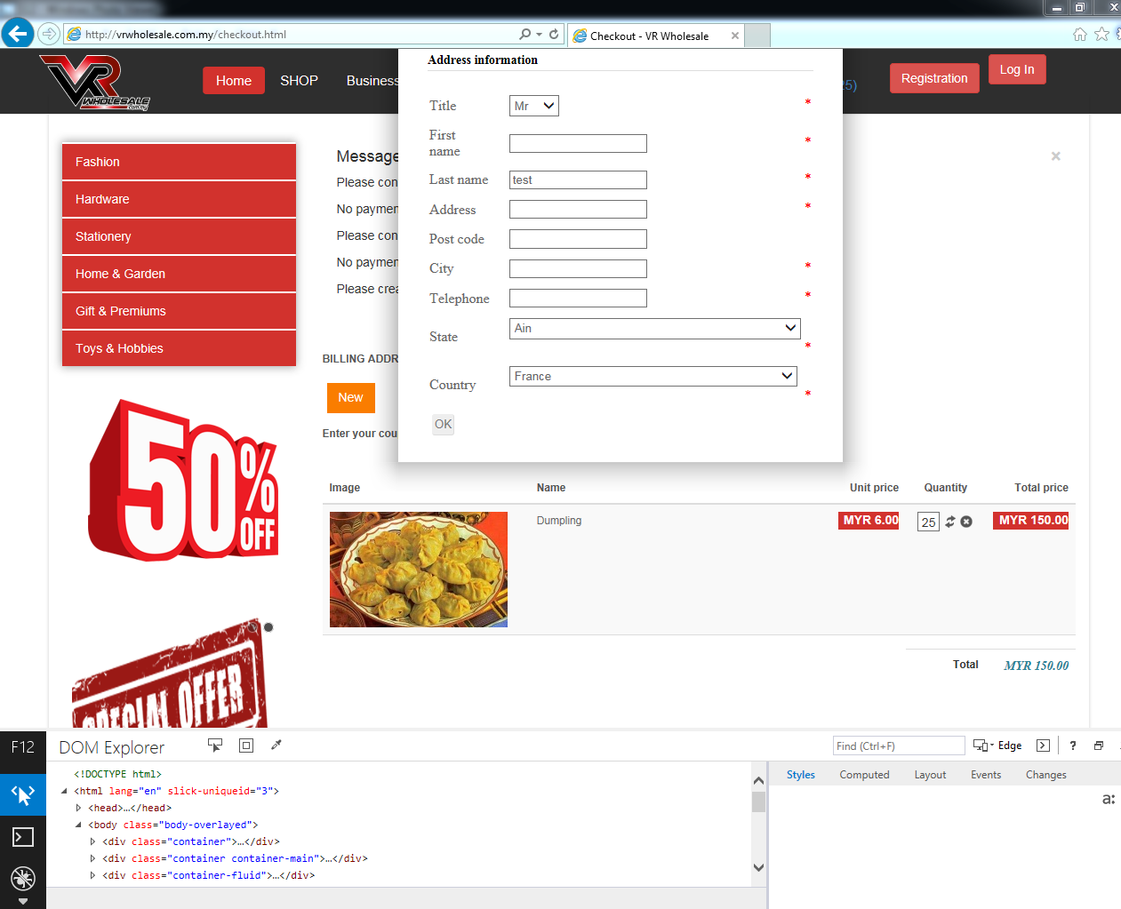

Address Information style change
  • Posts: 8
11 years 11 months ago #168005
-- Joomla version -- : 3.3.3
-- PHP version -- : 5.4.3
-- Browser(s) name and version -- : Chrome 36.0.1985.143
-- Error-message(debug-mod must be tuned on) -- : Modify registration form

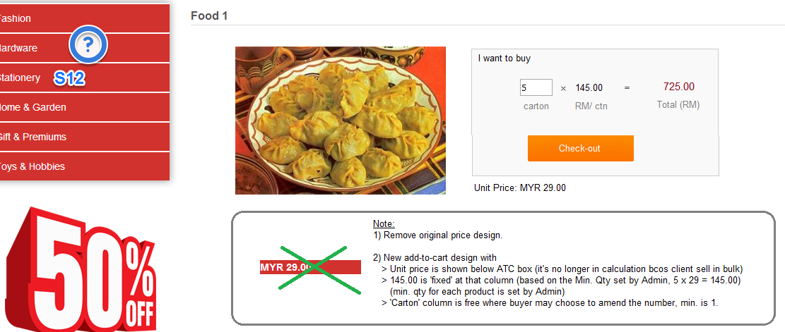

I am using hikashop starter and hikashop multivendor for one of my sites, the client want a modified look for the address information form, But I don't have a clue from where do I start. Need you guys help. I have also tried custom css from my template, but that didn't work too, as I see it is in an iframe. (need css style modification) Screenshot attached (attachment)
I also need Unit price to show in show_quantity.php, Please also advise how can I do that. I just need the price not the currency particularly in that place. like now it is MYR. 6 but need in this place only to show 6.
I have attached screenshot (S12) I want that exact output.
11 years 11 months ago #168009
1. You have to edit the css file of your template, as it's in a popup, the hikashop css is not loaded.

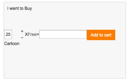

i want to show the price in the hikashop_product_quantity_main so i edit the show_quantity view as u can see from the attachment but i can't show the price in there. what i want to do is. show quantity X price = total price. how can i get the current products price as variable so that i can use jquery to calculate the total price in this part.
hope you understand.
  • Posts: 8
11 years 11 months ago #168123
i also try to do is below code and it show me Free in price section.

You can't use the code:
echo $this->loadTemplate();
in that view file because the data of the product/price is not loaded in that view file.
You would have to manually load it from the database basing yourself on the product_id in the $_REQUEST variable, so it's not easy to do that.
