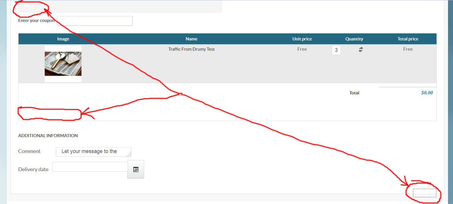

There are a few buttons on checkout page. They are ALMOST visible if you take a good look. THe button images are not shown but the words are in white and blends with background.

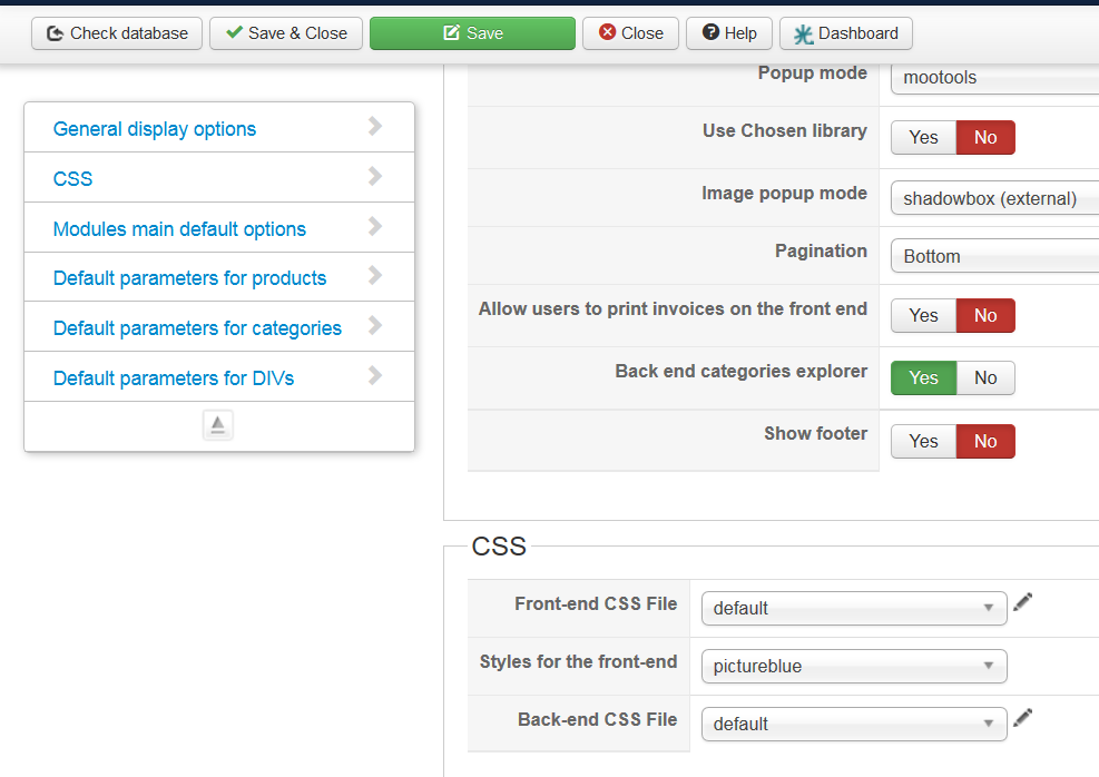

I believed if i add skin/ theme imageblue - it wil solve the problem. but it does not.

Sir, These example do me nothing, they are not exactly about my very problem .

Xavier,
I found that Blue Skin for HikaShop is not extended to check out . On the checkout page buttons are defined by my Joomla Template.
That is hard to swallow for we. I never expected that shop skin is only for a Cart and not for checkout. For me as a consumer it is ridiculous incomplete skin.
The advise given by Mohamed -was related to custom css and in my view - is totally unusefulness advise. He waist my time and I consider his reply to my ticket as not being professional. May be I am wrong. That is how it looks to me.

11 years 11 months ago #168475
In the blue style, there is indeed properties for these buttons:
.hikashop_cart_input_button{
	background-color:#f7f7f7;
	margin-top:10px;
	margin-bottom:10px;
	border-right: 1px solid #5f909c;
	border-bottom: 1px solid #5f909c;
	border-left: 1px solid #a6d0da;
	border-top: 1px solid #a6d0da;
	padding:3px 5px;
	color:#44646d;
	cursor:pointer;
	font-weight:bold;
	*padding:0px;
.hikashop_cart_input_button:hover{
	background-color:#8cacab;
	color:#fff;}
So I guess that your template was overriding the properties for the buttons.
