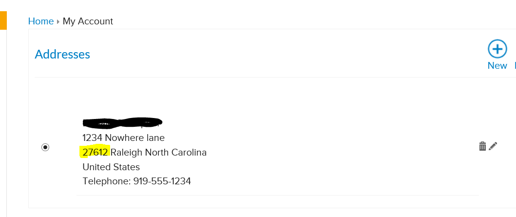

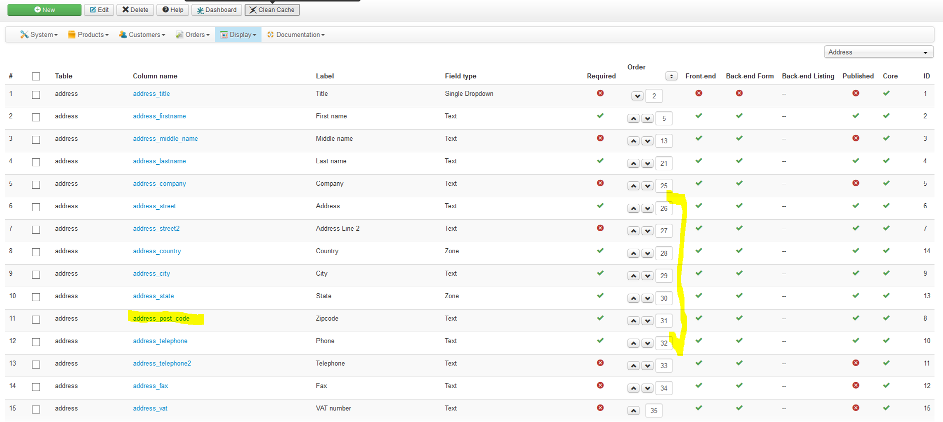

11 years 10 months ago #177259
We have the same problem, but a check of all of our custom fields shows that the postcode is correctly ordered AFTER the city and state in the backend. But the zip code is still showing up BEFORE the city name everywhere - frontend views, addresses, invoices emails, etc.

11 years 10 months ago #177307
I just tested it on my end and it worked fine, are you sure that you correctly changed the ordering of your custom fields through the "Ordering" tab of the page "Hikashop->Display->Custom fields" ?

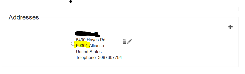

So supposedly the ordering should automatically address this issue, but it's not. We'll go look at the template, but attached are screenshots from our custom fields ordering, and both backend and frontend address views.
Everywhere the zips are showing in front of the city names, across the whole site. Seems like this should be corrected with a configuration fix, rather than have to go into several templates and modify them all.
Have been able to confirm the same exact problem on two different HikaShop sites, one running on 2.3.2 and one on 2.3.3.
