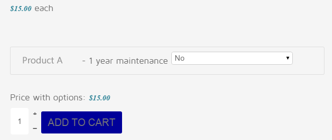

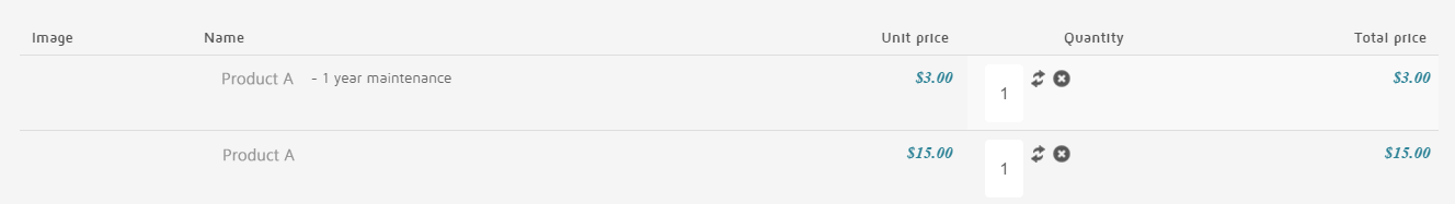

I have a software product ($100) that can have optional software maintenance ($20). When i go to the product page in hikashop, it displays the product option (as listed under Options), but it's a separate line item in the cart (one line shows $100 and the other line shows the maintenance option in another line for $20).
How do I configure hikashop's prdoucts so the option shows up in one line?

www.hikashop.com/support/support/documen...onfig.html#main_cart
Group options with products : When that option is activated, the options will be displayed together with the main product in the cart while when the option is deactivated, each option will be considered as a separate product in the cart.

That worked. Except how do I not have it listed as a product when I go to the Hikashop cart?
  • Posts: 85981
  • Thank you received: 14148
11 years 10 months ago #170242
If you activate the "group options with product" option, the options won't be listed as products on the HikaShop cart. So you should already be all good if you activated it.
