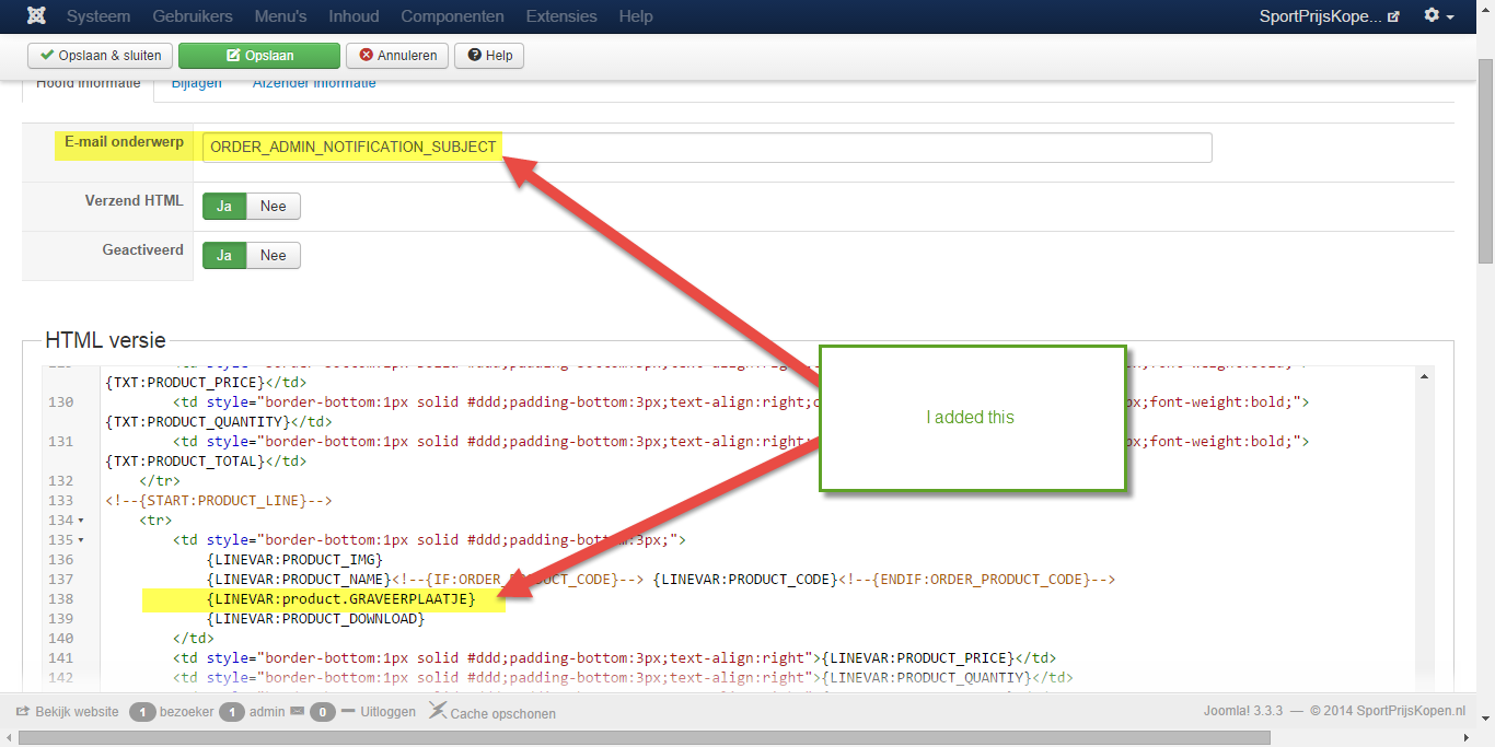

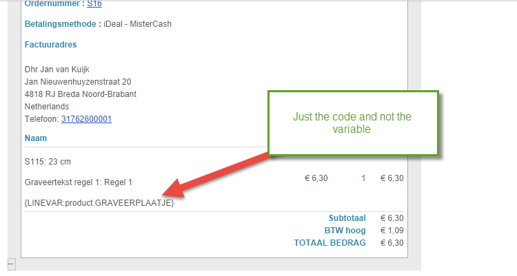

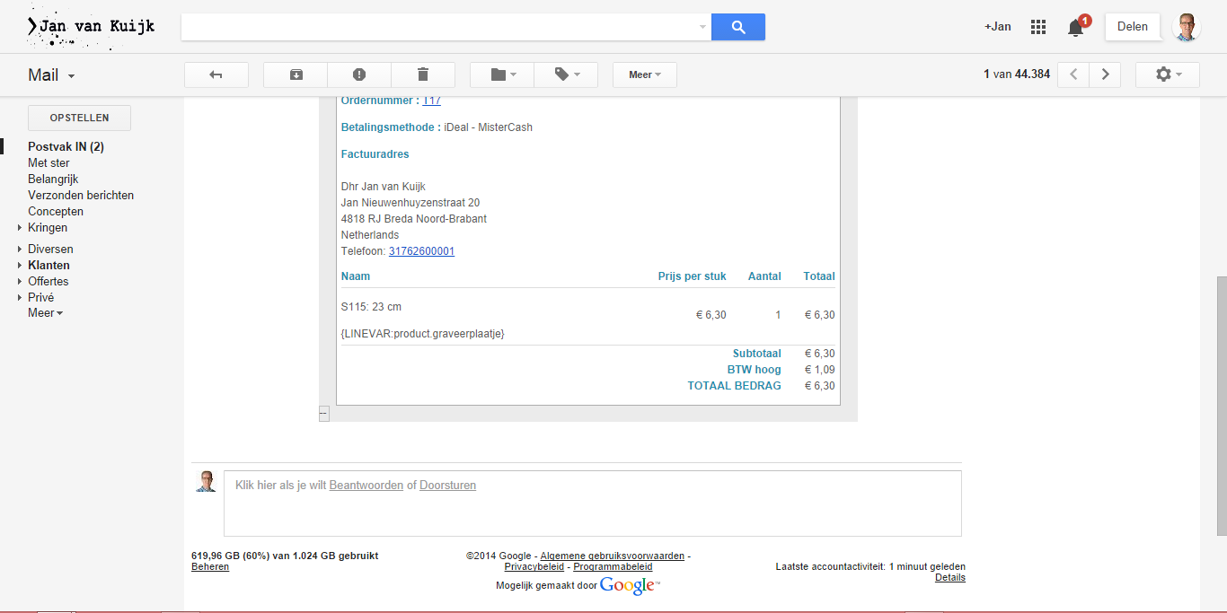

11 years 10 months ago #170472
I added this line: {LINEVAR:product.GRAVEERPLAATJE}
But without any result. Only the code is on the order e-mail and not the variable. See attached images.

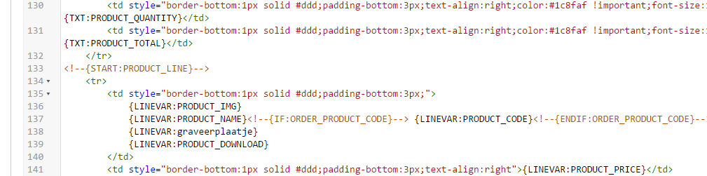

11 years 10 months ago #170603
No :-(
See attached printscreen.

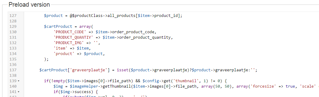

11 years 10 months ago #170610
Thanks to replace the currently added code by:
{LINEVAR:graveerplaatje}
And in the preload part, add:
$cartProduct['graveerplaatje'] = isset($product->graveerplaatje)?$product->graveerplaatje:'';
After:
		$cartProduct = array(
			'PRODUCT_CODE' => $item->order_product_code,
			'PRODUCT_QUANTIY' => $item->order_product_quantity,
			'PRODUCT_IMG' => '',
			'item' => $item,
			'product' => $product,

11 years 10 months ago #170732
Xavier no :-(
See attached files, but there isn't an text on the e-mail.

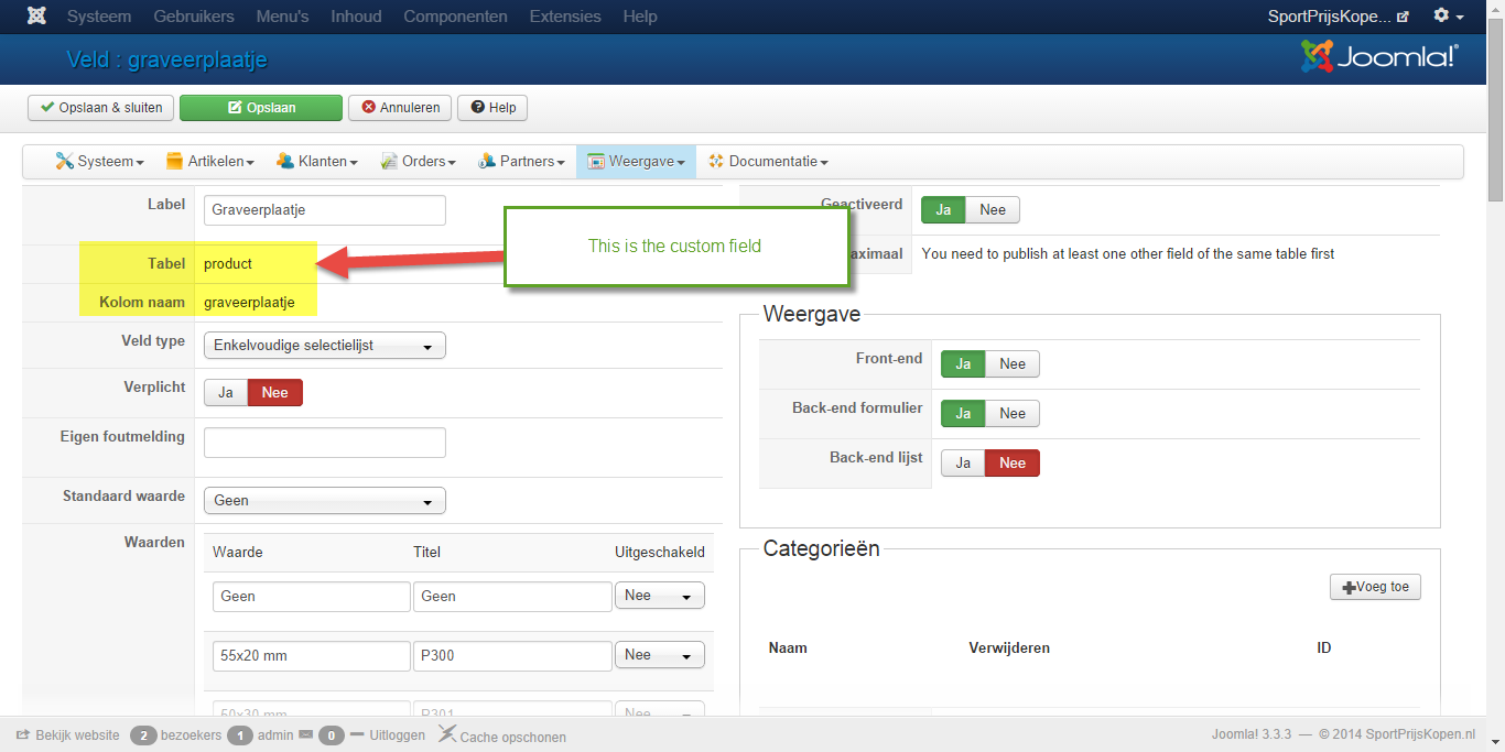

11 years 10 months ago #170761
Then this would indicate that you didn't enter any value in your custom product field for the product/variant you're testing with.
Could you check on that please ?

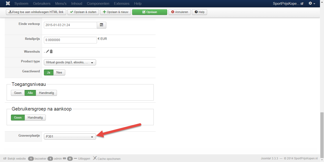

11 years 10 months ago #170840
There is a custom. See attached print screen.
