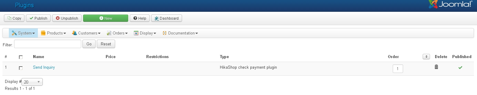

I have defined the products as virtual with no prize (0$).
I have created a new shipping method like it was recommended here: http://www.hikashop.com/forum/orders-management/869580-send-price-quote-instead-of-checkout.html#163372

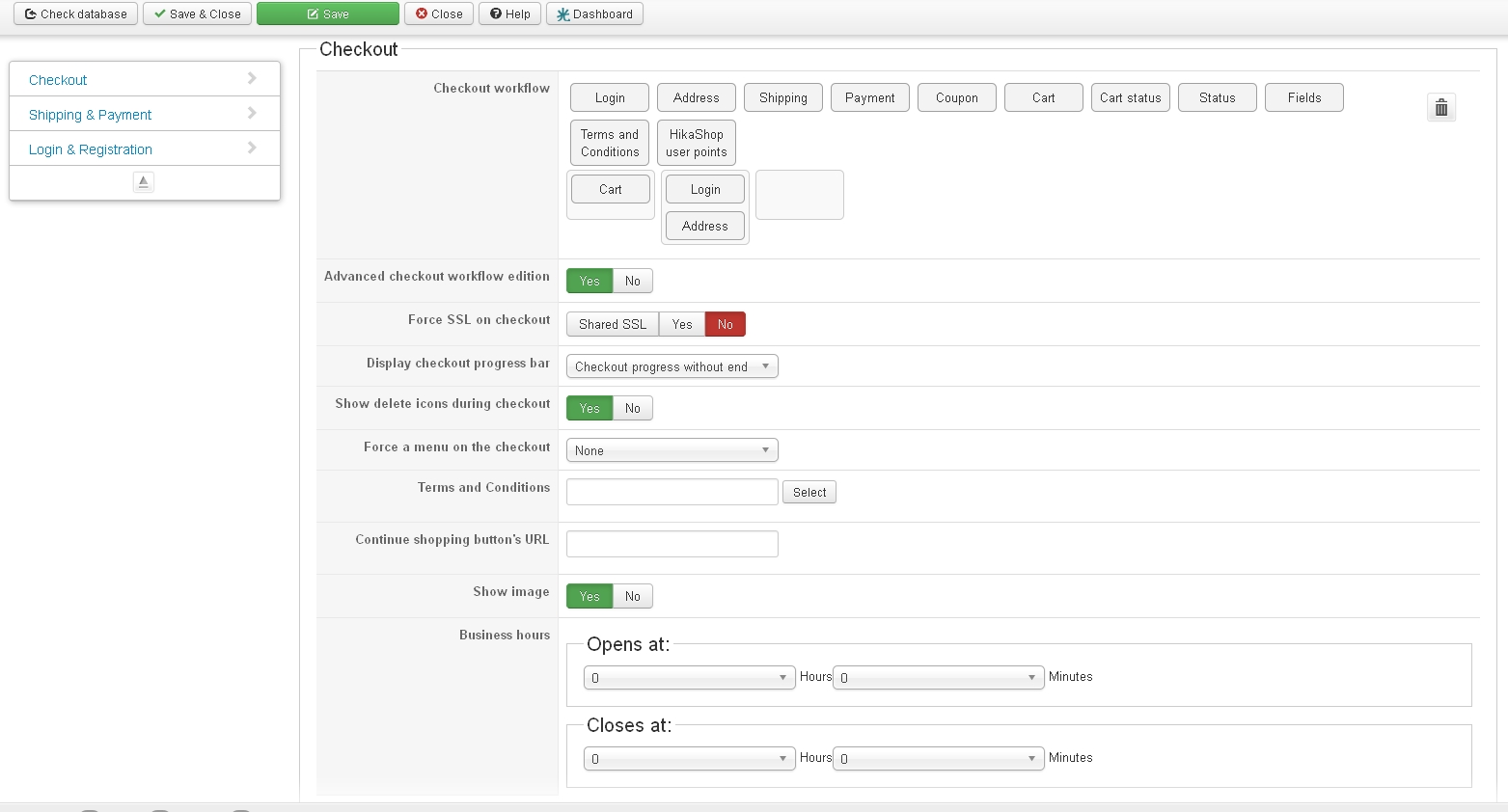

11 years 10 months ago #170923
If you don't need shipping form, so in the checkout workflow settings (Configuration > Checkout) you can remove the "shipping" step.
Then you can too set the checkout for "guests" in the options at the bottom of the page.

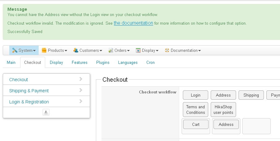

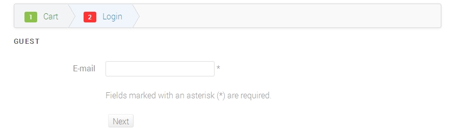

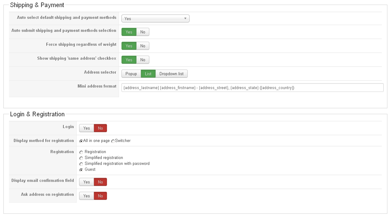

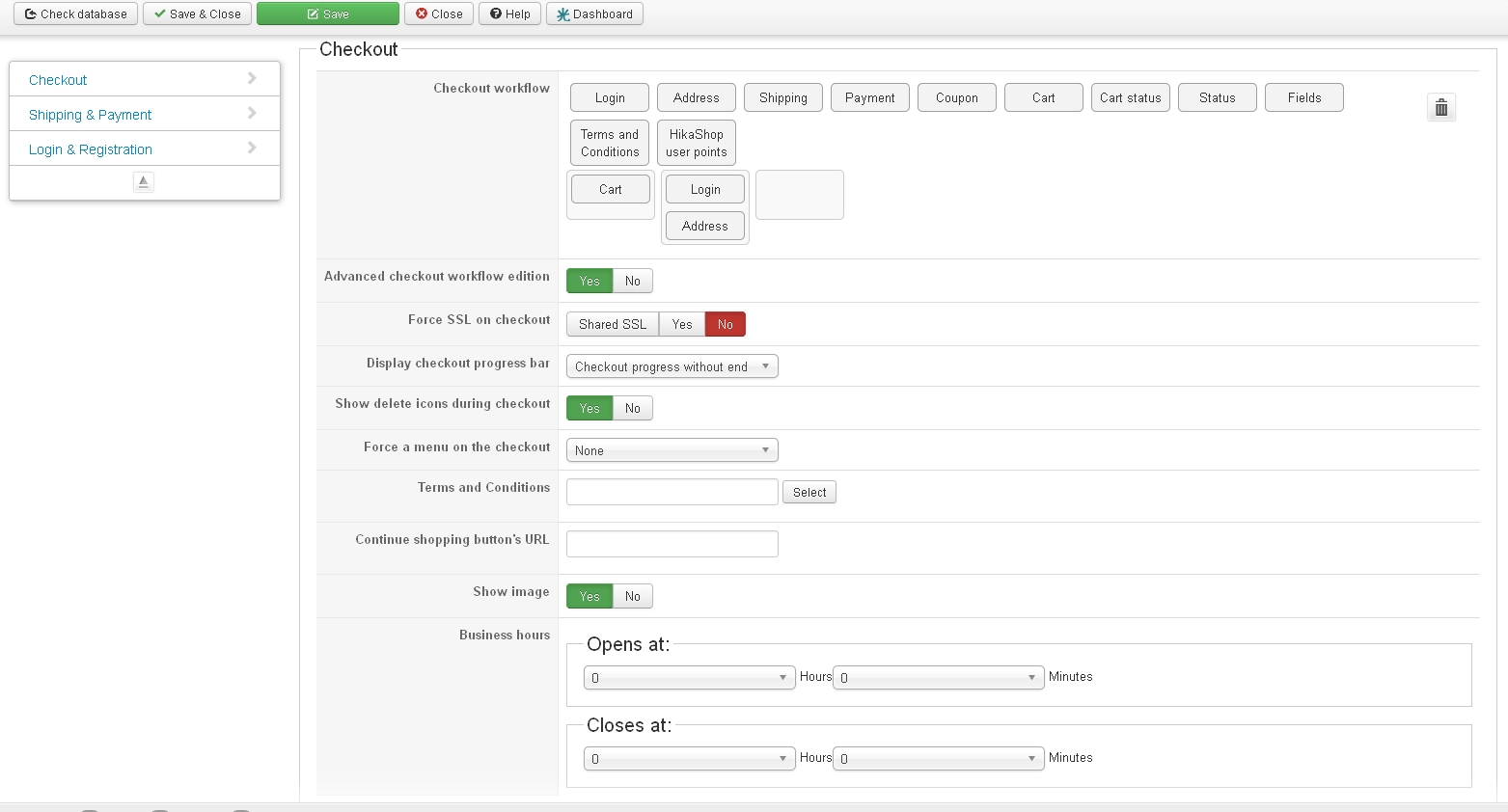

Hi Xavier and thank you for your reply.
I tried that before but the shipping form is always displayed with the adress form and the adress form always want to have a login element.
Enclosed I have uploaded screens from my current config of the Checkout process, the way the login massage is displayed and the message of the warning massage when I use address field without a login field.

  • Posts: 85981
  • Thank you received: 14148
11 years 10 months ago #171052
You want to have the "login" view in your checkout workflow. If you remove it, you wouldn't get the email address of the user and you wouldn't be able to reply to their contact request.
Why is that a problem to ask the user for his email address ?
  • Posts: 6
11 years 10 months ago #171059
Hi Nicolas.
My problem is that the user have to type in his e-mail address before he can set his contact data (address). In my opinion this should happen in the same form. I have not seen such a workflow at other online shops and I think it might confuse some potential customers.

11 years 10 months ago #171146
In Configuration > Checkout > Login & Registration thanks to enable the option "Ask address on registration".
