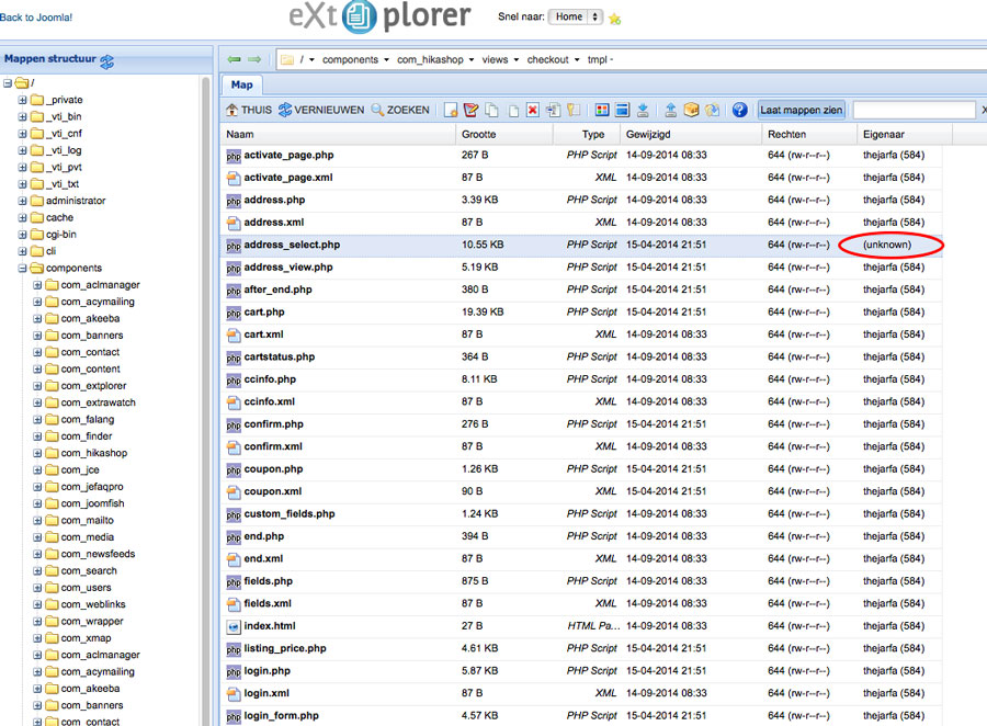

  • Posts: 88
11 years 10 months ago #171058
Hello Jerome,
Step 1 was already been done (coming from the help file)
If it does not solve the issue, please edit the file libraries/joomla/filesystem/folder.php
Around line 93 AND 122, please replace:
return JError::raiseError(-1, JText::_('Copy failed'));
by
return JError::raiseError(-1, JText::_('Copy failed').' '.$sfid.' => '.$dfid);
I got this error message : -1 - An error has occurred.
Copy failed /home/thejarfa/public_html/tmp/hikashop/front/views/checkout/tmpl/address_select.php => /home/thejarfa/public_html/components/com_hikashop/views/checkout/tmpl/address_select.php
there is something different about this file "address_select.php"
it says it has no owner ... is that normal ???
see attached document
Last edit: 11 years 10 months ago by jan2.
  • Posts: 26378
11 years 10 months ago #171070
Not it is not normal.
Please change the permission of that file and check the permission on the other folders ; so the update will be perform correctly by Joomla.
