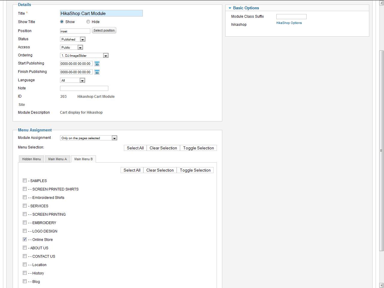

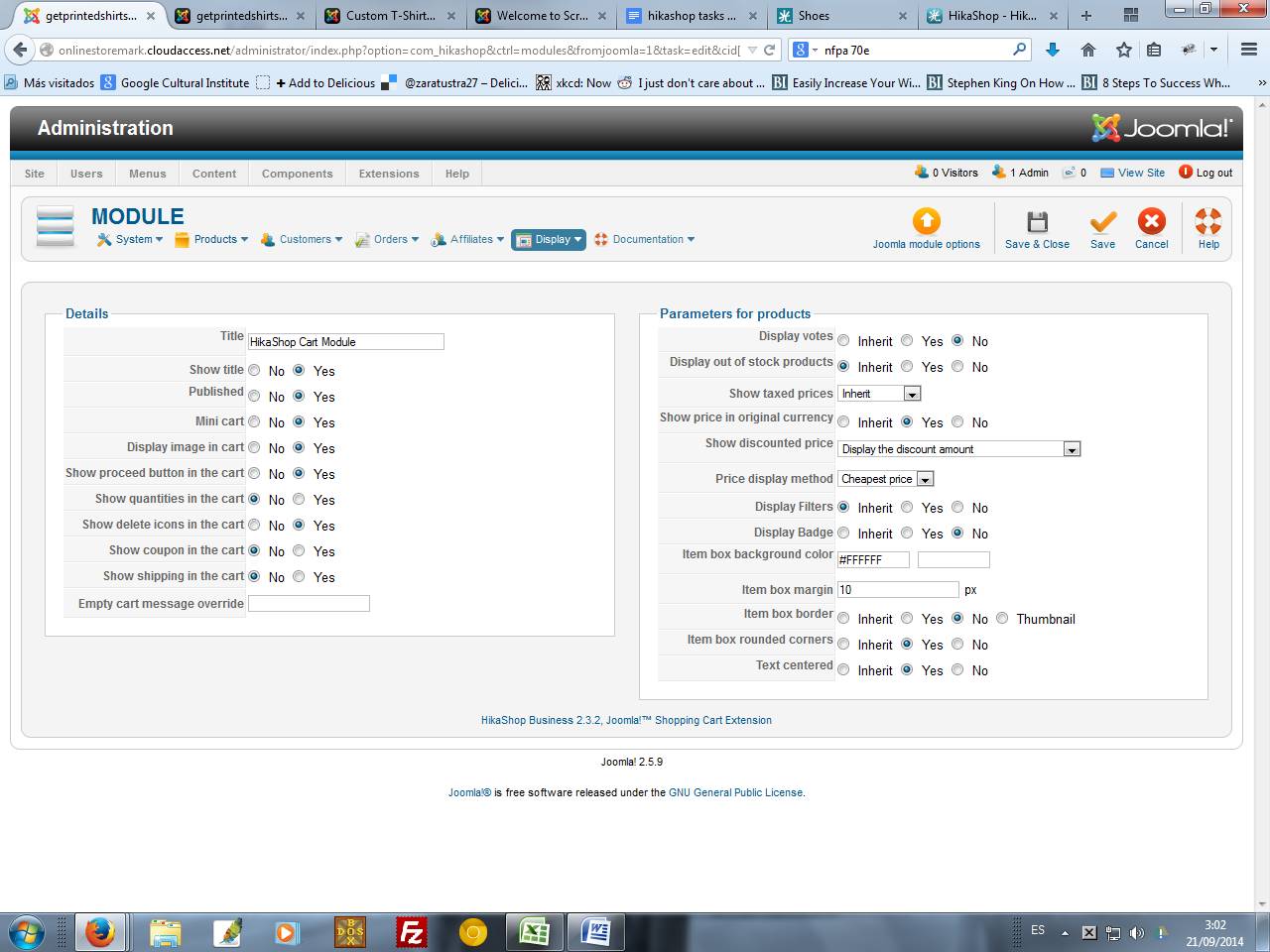

The module should be displayed at services>online store. There is a also 'store' link alias at main menu's top
I attach screenshots of joomla's settings and HS settings. I haven't made any other changes related to it.

  • Posts: 85981
  • Thank you received: 14148
11 years 10 months ago #172411
The problem is a SEF problem.
The menu services>online store points to the URL /shop/product/listing which is the "Shop" menu item that you have trashed and not to the URL of the "Online store" menu item that you have created.
It's probably some kind of alias or URL caching issue in MijoSEF on your website.
If you untrash and enable that "Shop" menu item and put in the hidden hikashop menus and select that menu item in the cart module menu assignment option, you'll see the cart module on that page.
But the proper way to fix that would be to fix the menu/SEF links in MijoSEF settings so that the URL of the menu items correspond to the menu items.
