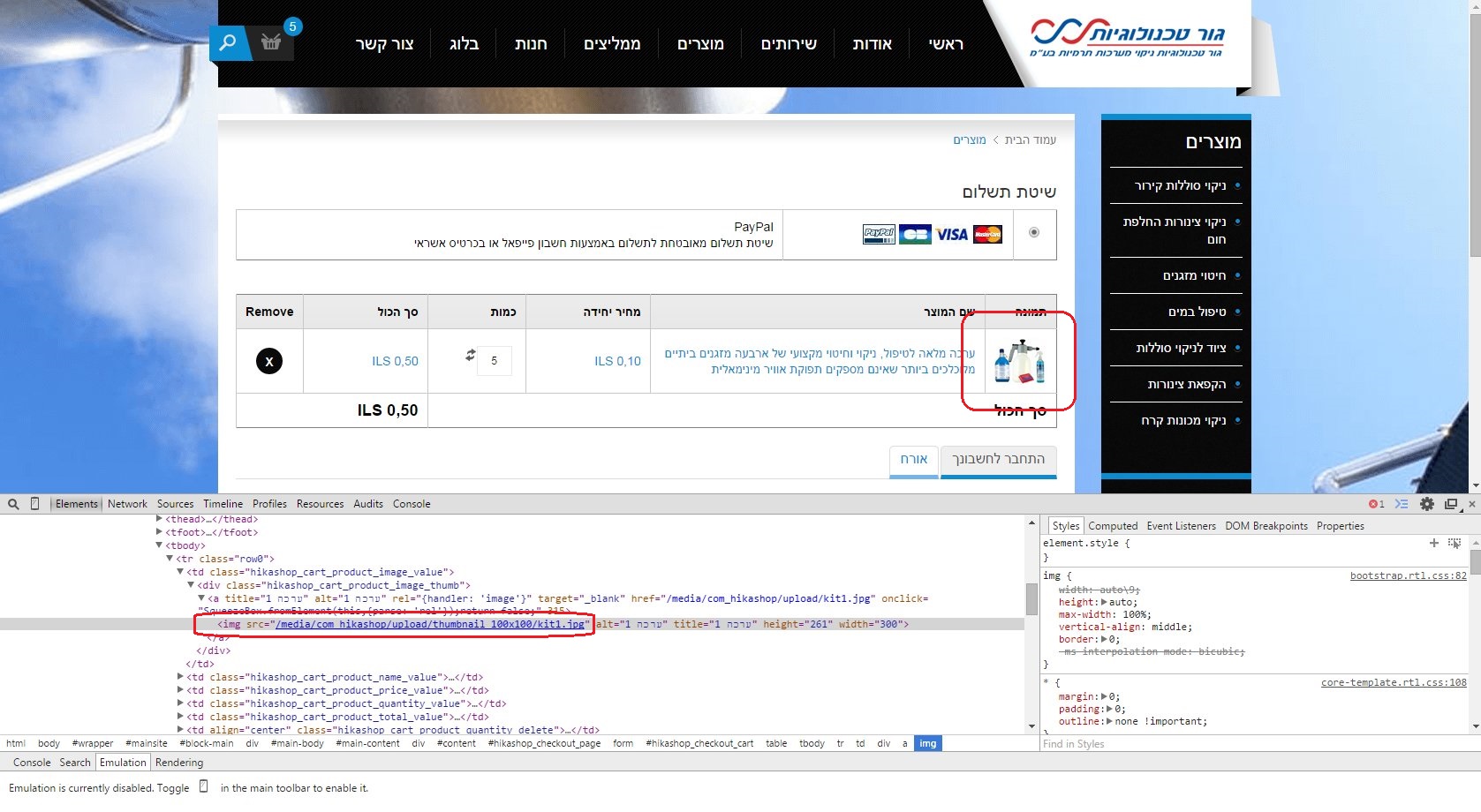

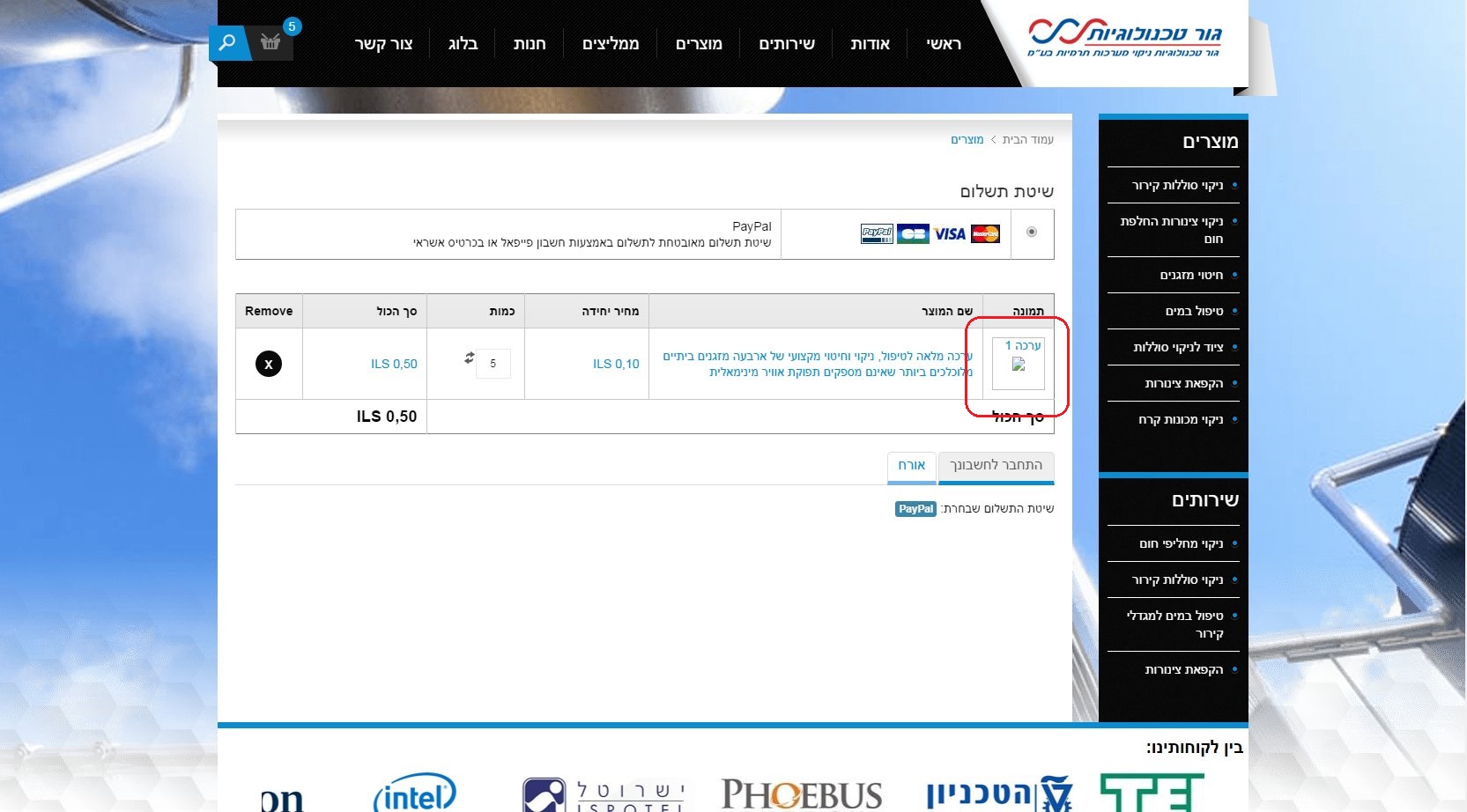

11 years 11 months ago #173395
Hi Xavier,
I really don't think it's a folder permission related issue. The Upload folder is set to 755 and I do have many thumbnails but they are located in other folders like thumbnail_100x100 and thumbnail_315x300.
In my opinion the solution should be a way to define thumbnail_100x100 as the default source folder for the thumbs.
Just to be clear, I've attached a screen shot of the missing thumbnails I'm talking about. Please notice in the second sample that after I've changed the folder path to 100_100 using Chrome console the thumbnail showed up. Now I need to find a way to permanently make this change.
Thank you,
Guy.

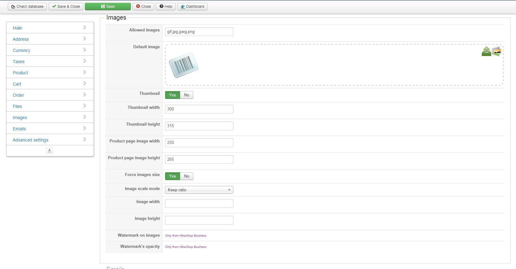

Please see attached screen shot as you've requested.
Correct me if I'm wring but this settings effect the product page image thumbs and have nothing to do with the checkout page product thumbnail. So why changing anything here?
11 years 11 months ago #173589
No this setting is the same one for the product page, the listings and in the checkout page.
If you want to force the path for the thumbnails in the checkout, you can edit the view "checkout / cart" and edit the image dimensions in the PHP variables.
