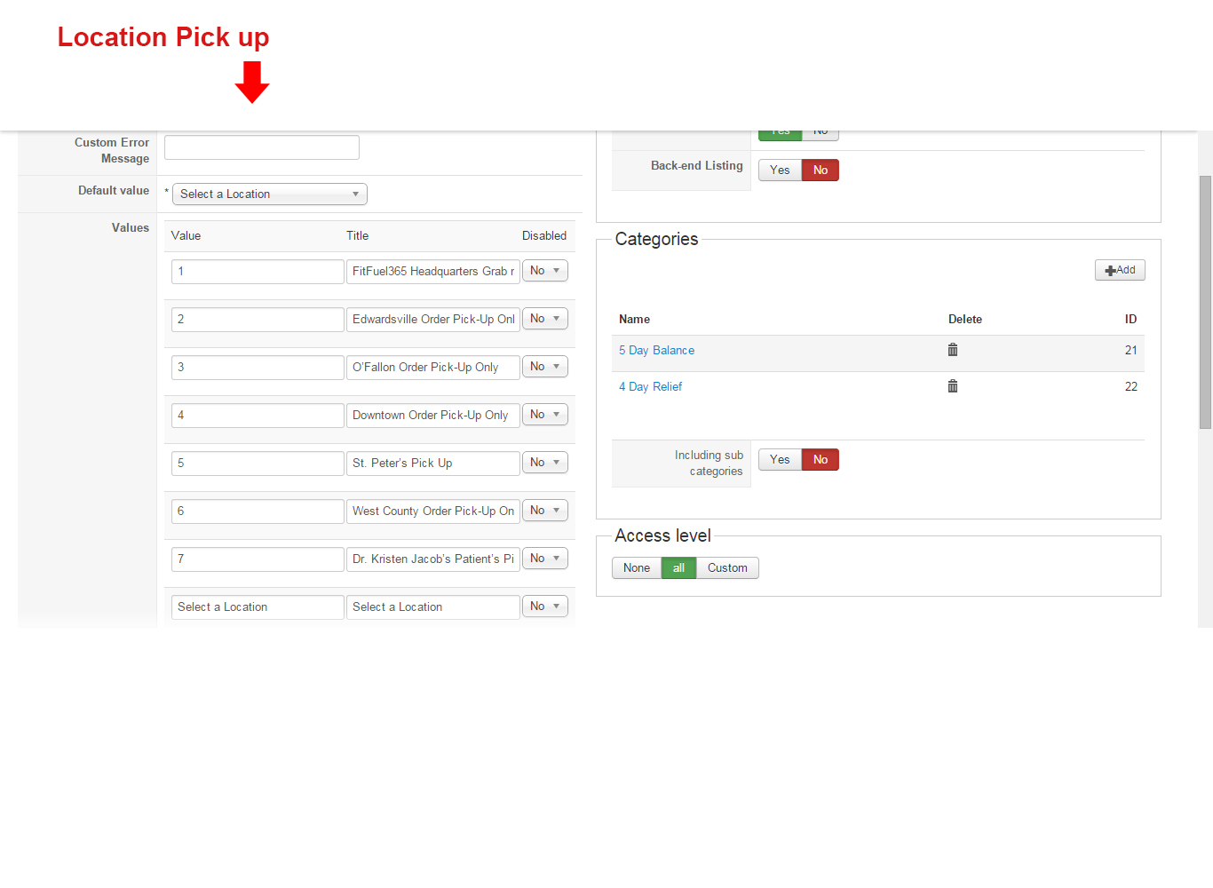

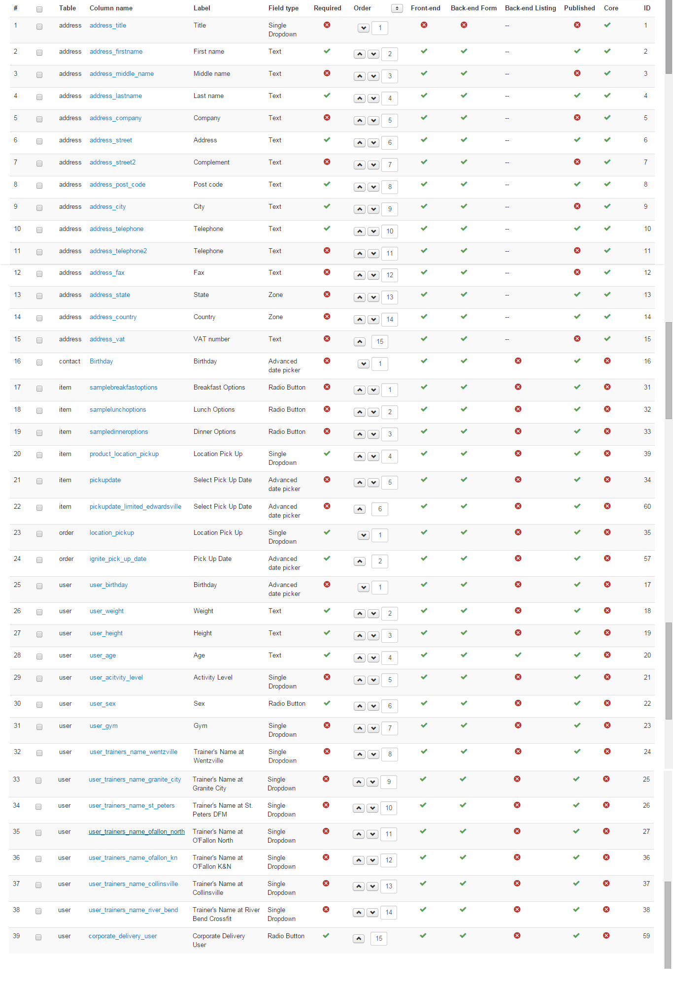

Hi Jerome,
Thank you so much for trying to help on this. It's really important part of the website.
Please, look at the attached screenshots. I currently deleted all the pick up dates fields and left only 2 for the first two options of the Location Pick Up field. The configuration is the same like the one on screenshot I sent you with a previous message, the only difference is that I disabled the Default today option for all cases.
One other important thing is that I don't see that the "Hour for extra day" is working at all!

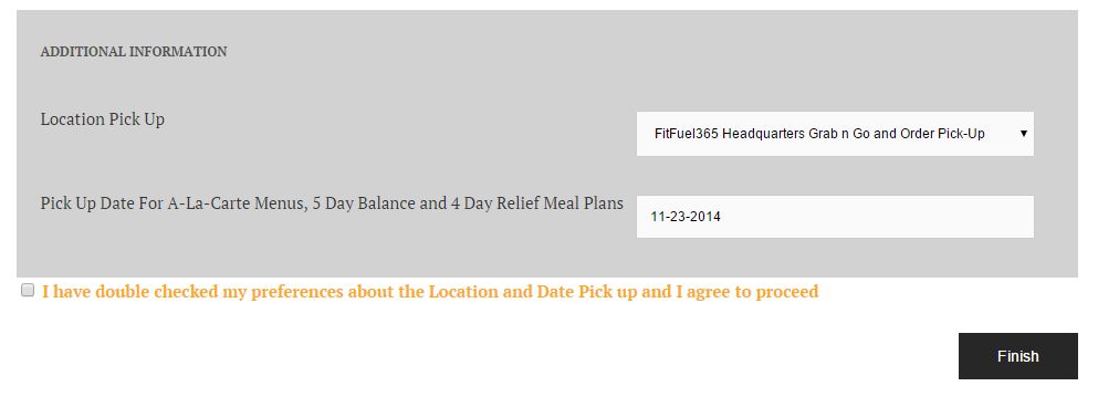

  • Posts: 80
11 years 10 months ago #178981
Hi Jerome,
I sent you a private message, I am not sure if you got it. The improvement didn't fix the issue. I have made some changes on the website for testing this. Please check the same fields now on the checkout page. What I have noticed is that only the date picker for the first location option is working well. Also, I am not sure how relevant is this, when I select the first location option there is a default day on it and when I select another location there isn't any (although the configuration is the same). One last thing is that on the backend when I have the location field accessable only for a particular group, then I don't get it's values for the "Display limited to" field at the date pickers.
