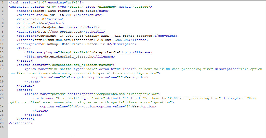

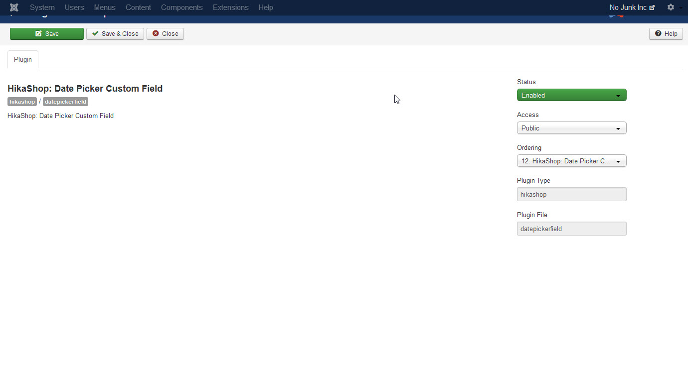

About the "Set hour to 12:00 when processing time" if you see my screenshot, I have not such setting in my plugin.
I can see in the datepicker.xml the option but strange not in joomla plugins screen
I made also a clean plugin installation (took it from the latest 2.5.0 version com_hikashop_business_v2.3.5_2015-01-29_16-07-57.zip) without success.

Strange. Zip the files in the folder of the plugin and install the zip via the Joomla installer. It might help to display the option.

I did that already 2 times, then used the ftp upload but nothing.
I also did it in a local installation and I have the same result!, no "Set hour to 12:00 when processing time"
Can you please check it?
Installation has problem.

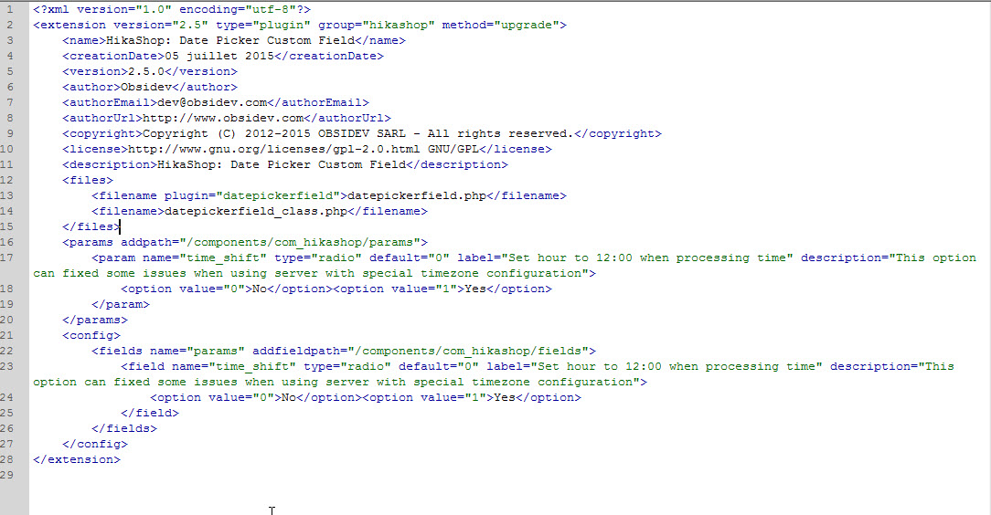

I have the attached plugin from your latest pack

Nicolas missed the typo issue which will be fixed in the next release.
In the XML, the "fieldset" was missing
	<config>
		<fields name="params" addfieldpath="/components/com_hikashop/fields">
			<fieldset name="basic">
				<field name="time_shift" type="radio" default="0" label="Set hour to 12:00 when processing time" description="This option can fixed some issues when using server with special timezone configuration">
					<option value="0">No</option><option value="1">Yes</option>
				</field>
			</fieldset>
		</fields>
	</config>

Thanks Jerome
I edited the .xml and the "Set hour to 12:00 when processing time" is there now.
So I checked it to see if our problem will be fixed.
