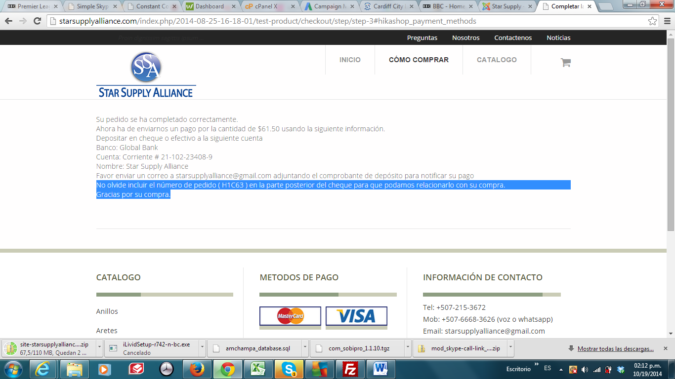

-- Error-message(debug-mod must be tuned on) -- : Hi,
Where can I find the place to delete the highlighted text in the attached screen shot (No olvide incluir el número de pedido ( H1C63 ) en la parte posterior del cheque para que podamos relacionarlo con su compra.
Gracias por su compra.) from the page.
The rest of the text is set up in the HikaShop check payment plugin but I cannot find this text
Thanks,
Mike
Thanks,
Mike

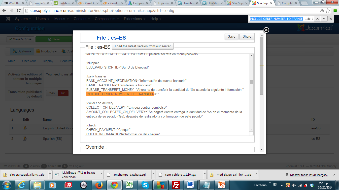

You can use a translation override in order to change that text:
  • Posts: 122
11 years 11 months ago #176296
Thanks I will know where to look now.
However, as you can see from the attached screen shot, I have removed the text but it still appears in the bank deposit confirmation page
How can this be?
Mike

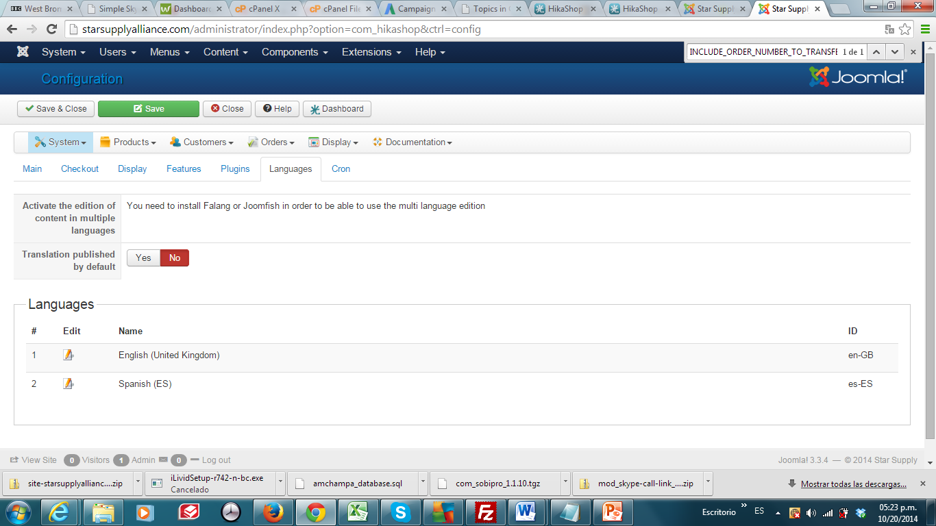

  • Posts: 122
11 years 11 months ago #176297
Is it because You need to install Falang or Joomfish in order to be able to use the multi language edition ?
See attached.
Mike
11 years 10 months ago #176316
I don't think that you have to use FaLang or JoomFish for that, if you add the translation override for each languages it's ok.
Please check if there is not another entry in the language file for the confirmation page.
