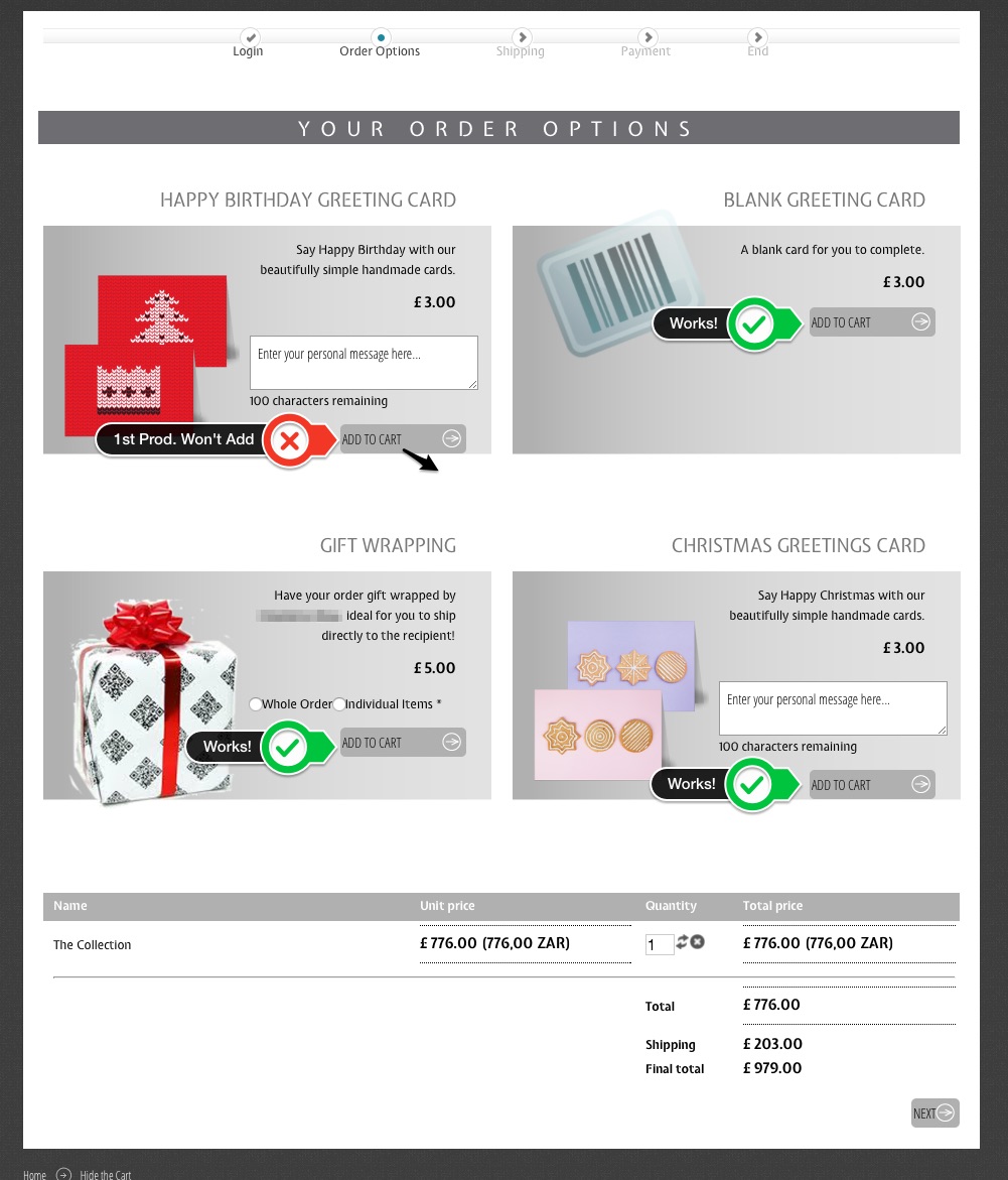

OK, so my client has asked me to add a new section in the checkout workflow which would allow a customer to add Gift Cards and Gift Wrapping to their order. It needs to be part of the checkout flow as it's very much an overall order enhancement value add.
So, to make this work I decided to use the Additional Information hook in the checkout flow and created a simple text field with a Modules Anywhere plug-in call to load a Hikashop Content Module which displays the order options products which I've created in two categories Greeting Cards and Gift Wrap. I used a language override to change the name from Additional Information to Your Order Options.
It works nicely - the value added products are displayed (screenshot attached).
BUT
The first product in the displayed Hikashop Content Module does not get added to the cart when Add to Cart is clicked. Instead it takes me back to the home page of the site. Every other product works and I do not know why!
ALSO
I'd like to find a way for Gift Wrapping to be made Free when the total order is over a certain amount? I thought I could do this using a Discount, but Discount does not provide a Restriction whereby it would apply the discount when the order is over a certain amount. How could I achieve this?

1. It's because you're displaying your content module inside the checkout and the checkout already has a form element around all the views of the checkout. And since each product has its own form for the add to cart, the first product's form get mixed up by the browser with the main form of the checkout and it doesn't behave properly.
One solution would be to add some custom HTML before your content module and after it to close the checkout form (and other html elements) before the content module HTML, and then open them again after it for the cart view and the next button below it. That way, you would get valid HTML and all the add to cart buttons of the module would work.
2. Discounts apply directly on the price of the products and thus cannot have global cart restrictions.
An alternative I can propose would be to create a coupon with the "auto load" option activated, the minimum order amount value and the gift wrapping product selected in its product option. The coupon would be then be loaded automatically during the checkout if the gift wrapping product would be in the cart and the total of the cart would be above the amount entered in the coupon.
